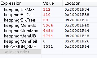

Hello! I use custor simple_peripheral project on custom board. All works good, but after long time (40min, hour, 1.5 hours) i get an exeption.

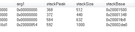

Tasks stacks, heap are looks good. What could be the problem?

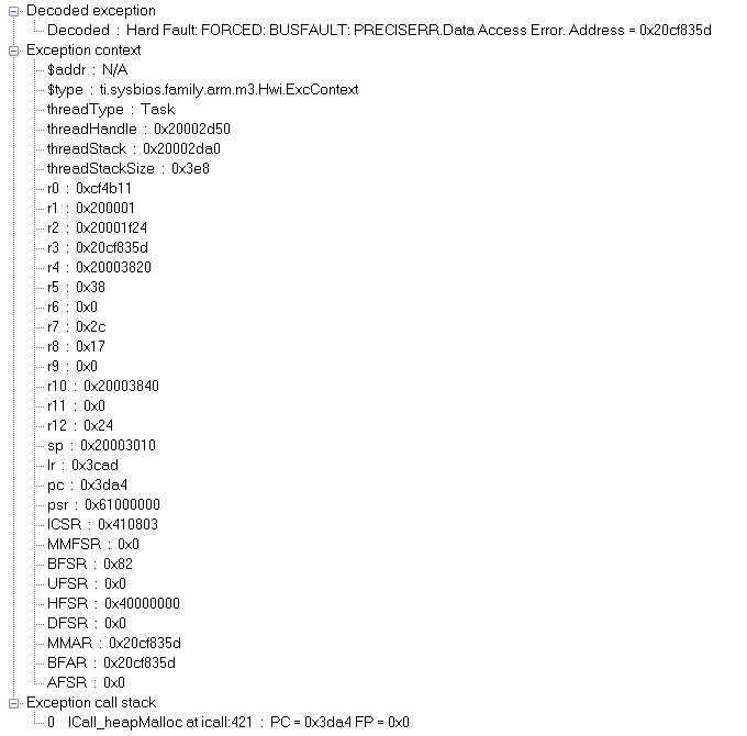

[ti_sysbios_family_arm_m3_Hwi_excHandler__I + 0xd]
 The processor has escalated a configurable-priority exception to HardFault.
   A precise data access error has occurred (CFSR.PRECISERR, BFAR) at data address 0x81ac6e48.
Exception occured at PC = 0x3da4, LR = 0x3cad
See the call stack for more information.

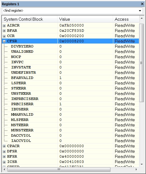

  • Hello, Joakim!
    Yes. Using this section, I got the information that I attached in the first post. What else can I see to solve the problem?
  • Hello Alex,
    It`s hard to to say.
    The data access error address from your exception information screen shot is 0x20CF835D. The RAM address start at 0x20000000 and CF835D is far over the valid range (13,599,581) as there is only 20 kB of RAM on CC2640R2F. I wild guess might be that somewhere in your code a far to big heap block is requested and HEAPMGR_MALLOC tries to allocate regardless.

  • Hello Alex,
    Sorry for the delayed response. I believe the heap is corrupted before the hard fault occur.
    The way malloc works when allocating a new block is to scan the heap from heap start and read the length field of each block to determine the size of the current block, then skip length number of bytes and read the next block length until a free block is found. Most likely you heap is already corrupted from a earlier write where perhaps a block write overwrite the next block length header which can cause malloc to read an invalid length field and skip out of bounds.
    Here are a few suggestions:
    1. Just to make sure, try to increase your application stack size. even though stack peak is below at 584/632 there can be cases where the stack peak is higher than what is reported.

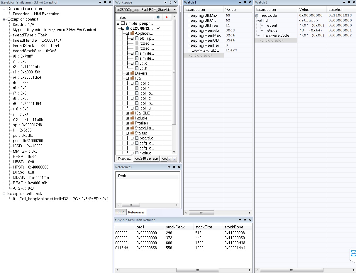

  • Hello, Eirik! Thanks for answer!
    //1. Just to make sure, try to increase your application stack size. even though stack peak is below at 584/632 there can be cases where the stack peak is higher than what is reported.
    I increased stack size from 640 to 1600. Now i use CACHE_AS_RAM=1 but the problem with hard fault still stay.

    //3. You can also try to change to Heaptrack+heapmem and use ROV to inspect the heap to locate corrupted blocks. You might have to increase some of the task stack sizes when using this.
    I attached ROV windows with inspection of hard fault (with hardCode details). Is it that you asked?

    3)
    You can refer to the users guide on how to change the heap configuration to heapmem+heapstack. Then you will get a separate HeapMem module module in ROV.
    http://dev.ti.com/tirex/explore/content/simplelink_cc2640r2_sdk_3_20_00_21/docs/blestack/ble_user_guide/html/ble-stack-common/memory_management.html?highlight=heapmem#configuring-the-heap
