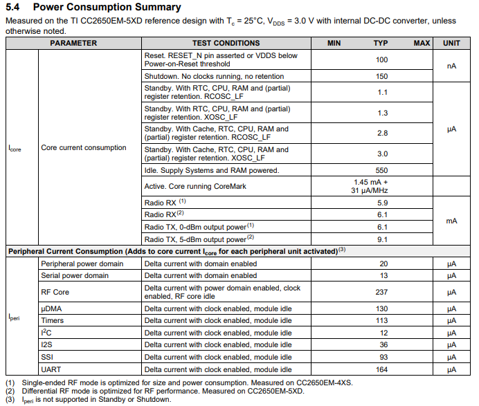

I would like to know Power Consumption Summary if the MCU is supplied 1.8V.
How can I get these information?
The datasheet only shows Power Consumption Summary when 3.3V is supplied.
Any helps or suggestions is much appreciated.

You can get an indication by looking at figure 5.10, 5.11, 5.15 in the datasheet (http://www.ti.com/lit/ds/symlink/cc2640r2f.pdf)
We don't have these numbers for other voltages than 3.0 V is in the datasheet.
The numbers will scale with the same factor as the figures I referred to.
