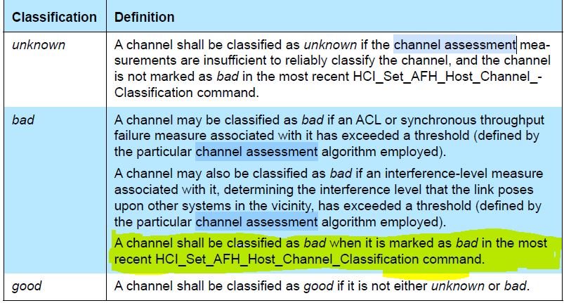

  • Hi Michael,
    As per specification A channel shall be classified as bad when it is marked as bad in the most recent HCI_Set_AFH_Host_Channel_Classification command.  That means when we set this value from host repeatedly on a loop (delay of 2s) , the controller(slave) should take this value and report same channel map to master in subsequent channel classification messages, but the slave controller not following this. Attached specification chapter 8.6.8 for your refernce.
    Sridhar.

  • Hi Sridhar,
    The behavior you describe is working as intended. The SET_AFH command is only used by the master if the AFH hop sequence need to be changed. If there is no need for a change due to the channel map staying the same, then the master will not send that command.
    If you run your logging for longer or introduce some interference nearby, you should observe the master sending out SET_AFH commands as the channel reports by the slave change.
    Michael
