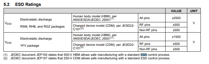

    The datasheet specifies a much lower ESD voltage rating:
  • It's the customers responsibility to add system ESD protection to ensure that the chip is not exposed to higher voltage levels than stated in the datasheet.

  • If I remember correctly you have some ESD protection on the touchpad (code). Since the CC2640R2F is mounted on a board that is placed inside the door I would assume that the doos take some of the ESD charge. TO find out where the board needs more protection, have you tried to disconnect the touchpad to see if the main charge comes into the board this way or done other delta testing to see which part of the design is most sensitive?

    The ESD strike can enter the chip in a number of different ways pending your layout and casing. The antenna is a common route for ESD and recommend to protection the antenna port with TPD1E0B04: http://www.ti.com/product/TPD1E0B04.
    This has a low capacitance so the antenna will not need to be re-tuned.

    Air discharge + -15kv, we haven't found any broken antenna ports at present. Those chips that are found to be broken are all VDDS3 pins or VDDS2 pins shorted to the large middle pad.
    The antenna is susceptible to ESD since this is normally positioned outside the GND region and in a more free space which makes it more prone for the ESD strike and to carry the energy to the radio pcb.
    Recommend to add an ESD protection on the antenna as close as possible to the antenna.
    Look at the part: TPD1E01B04 : http://www.ti.com/lit/ds/symlink/tpd1e01b04.pdf which has low capacitance (antenna does not need to be re-tuned) and meets your ESD levels.
    IEC 61000-4-2 Level 4 ESD Protection – ±15-kV Contact Discharge – ±17-kV Air Gap Discharge
