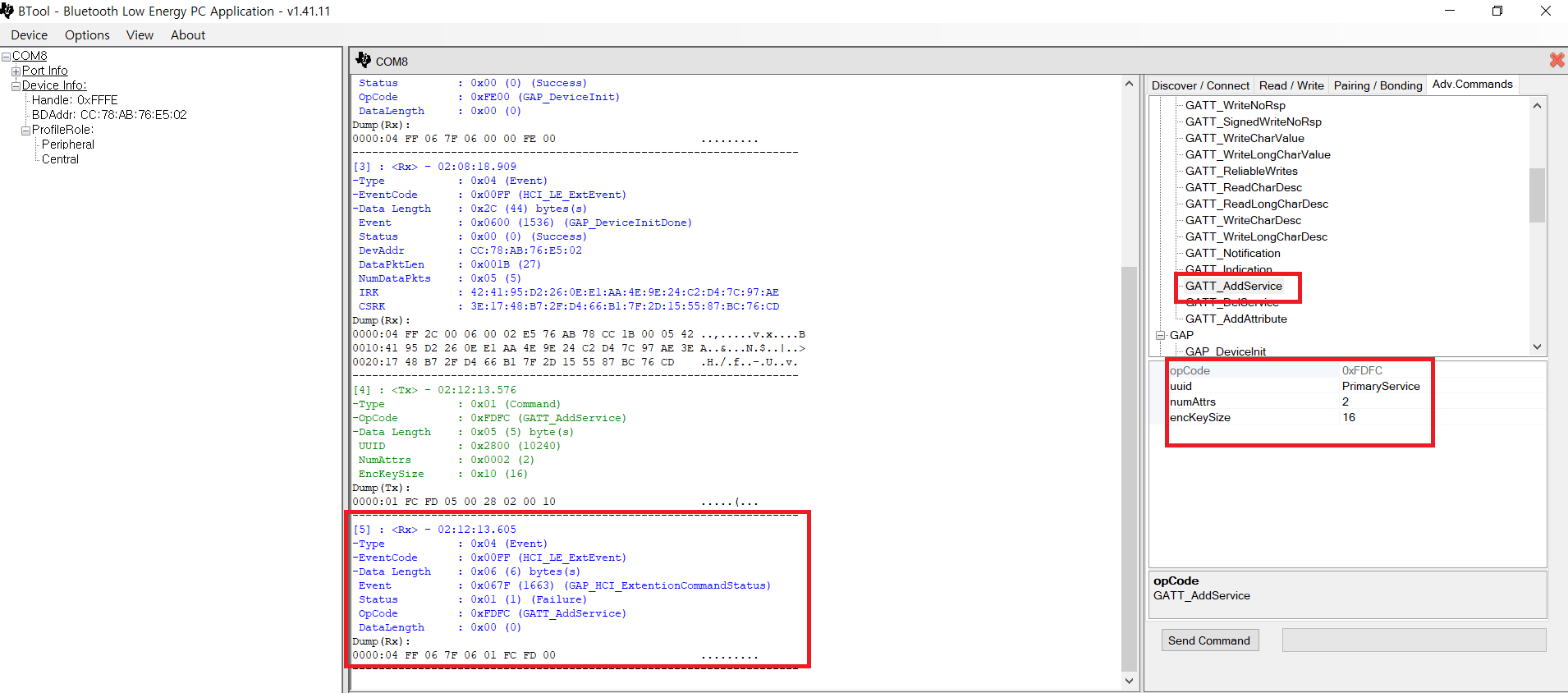

I am testing Dual mode (Central, Peripheral) using the HOST test program.
My device <-HCI->CC2650(Host test) <->central device(android phone()
<->Peripheral device
Using the btool PC Application, the Central command of the host test is well controlled.
However, the Peripheral command in the host test is not well controlled.
An error occurs when the ADDservice command is executed.
Please use the HCI command to explain the ADD service and Advertising sequence.
thanks,
SC Lee.

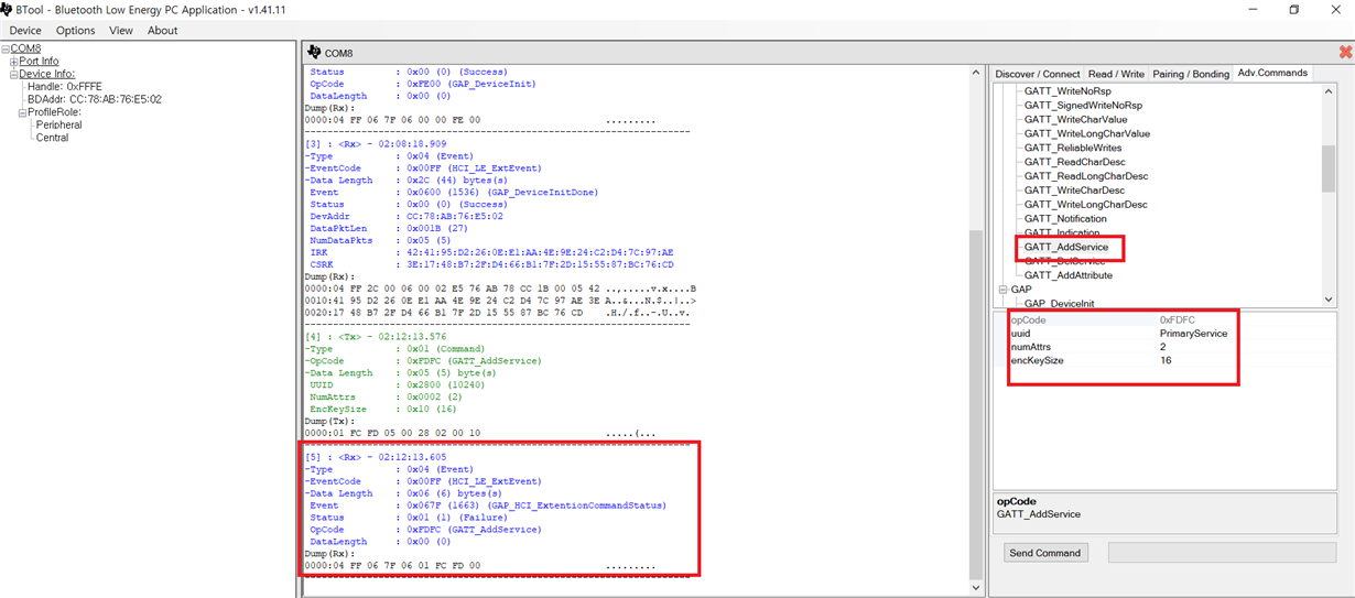

  • In the Host test PC program, we proceeded as follows.
    Step 1: Changed to Central and Peripaher mode with GAP_DeviceInit command.
    Step 2:If GATT_AddService command is used, Failure is returned.
    Are there any commands that need to be added before running the GATT_AddService command?
    thanks,
    SC Lee.
  • Hello SC Lee,
    Then you need to un-comment DGATT_DB_OFF_CHIP in build_config.opt found under the TOOLS folder in the host_test_stack project. DO a full rebuild after that:
    /* GATT Database being off chip */
    -DGATT_DB_OFF_CHIP
    Please note that it might be difficult to manage the complete GATT database from BTool. We have no guide for this. Another options is to implement the required service implementation in the host_test application itself.

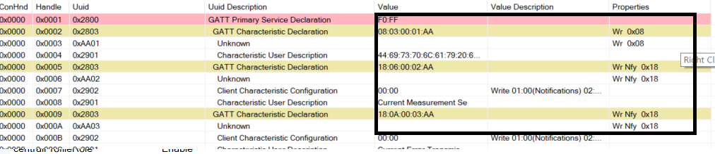

    2) How to set Value, Value Description and Properties?
    I am setting it like an image.
    In case of SNP protocol, it can be set to 9.5.2 SNP Add Characteristic Value Declaration (0x82).and 9.5.3 SNP Add Characteristic Descriptor Declaration (0x83)
    Which command should be used in HCI protocol?
     thanks,
    SC Lee.
  • Hello SC Lee,
    We don not have guide for how to setup and manage the GATT server from BTool. When database is off chip your application processor (BTool emulates) would have to process all incoming ATT requests.
    A simpler approach is to add the desired profile/service into the HostTest application and compile it in the actual firmware. Then all the GATT/ATT requests could also be handled by the HostTest application on the CC2650.
