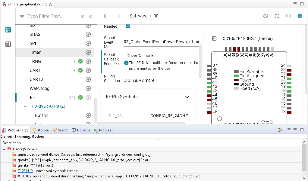

We uploaded a sample project from ble5stack. Here in the default SysCfg board file for IO configuration it is not allowing to re assign. For ex: BTN1 is locked to IOID_15, if I want to use IOID_15 for other purpose then I have to select "Use Hardware"
To overcome this I created the Custom Board in the SysCfg UI. But now it is showing an error as below (rfDriverCallbackCustom)
Kindly help me in fixing this.

  • Hi Yasar,
    Which exact changed did you do? It looks to me like you need to go into the "RF" module of SysConfig and re-configure the callback function name to the old one (assuming that what ever changed you did added "Custom" to the end of the old name).

  • Hi Yasar,
    It is still not clear what changes you did in the SysConfig? For the "P" devices this callback is already defined in the application (and should be named "rfDriverCallback" if I remember correctly). It sounds to me that what ever happened in your SysConfig file ended up changing the expected name (putting a "Custom" on the end), did you try to remove the "custom" part?
  • Hi M-W,
    1. Added a custom board in SysCfg
    2. Renamed the Callback funtion
    3. Build the project and observing the error
    We  found the callback definition in the ti_drivers_config.c is not present and it automatically modifies the callback functions prototype to
    extern void rfDriverCallback(RF_Handle client, RF_GlobalEvent event, void* arg);
    To overcome this, we defined the  callback function in SimplePeripheral.c (earlier copied  the same callback's definition from ti_drivers_config.c) and that time we are able to build without error.

  • Hi Yasar,
    Can your share your definition of it? Also, what state is the application in when the device stops advertising (if you debug it)?

  • Hi Yasar,
    Could you comment on the state of the application when "not running"?
  • HI M-W,
    PFA. Sorry, I missed that in my last reply.
    Thanks & Regards,
    Yasar Arafath
  • HI Yasar,
    Can't say for sure, but it looks like you might having an exception in hardware. Could you open up the Runtime Object View and try to check for exceptions (under the Hwi view) etc.?
