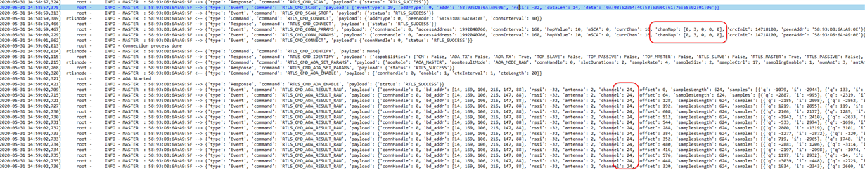

  • update log for chan_map
    Nice! Glad to see you are making progress here. Can you confirm this is what you expected?
    Can you also provide a few details on how you managed to do this? (I am pretty sure other people will benefit from that).
  • Hi Clément,
    I am sorry to have confused you
    I just check the chan_map have be updated to only 2 channel(0x3 means channel 1,2 . am i right?). but the start channel is 24 and it also hopping channel from 0~39(sorry, i should show more log)
