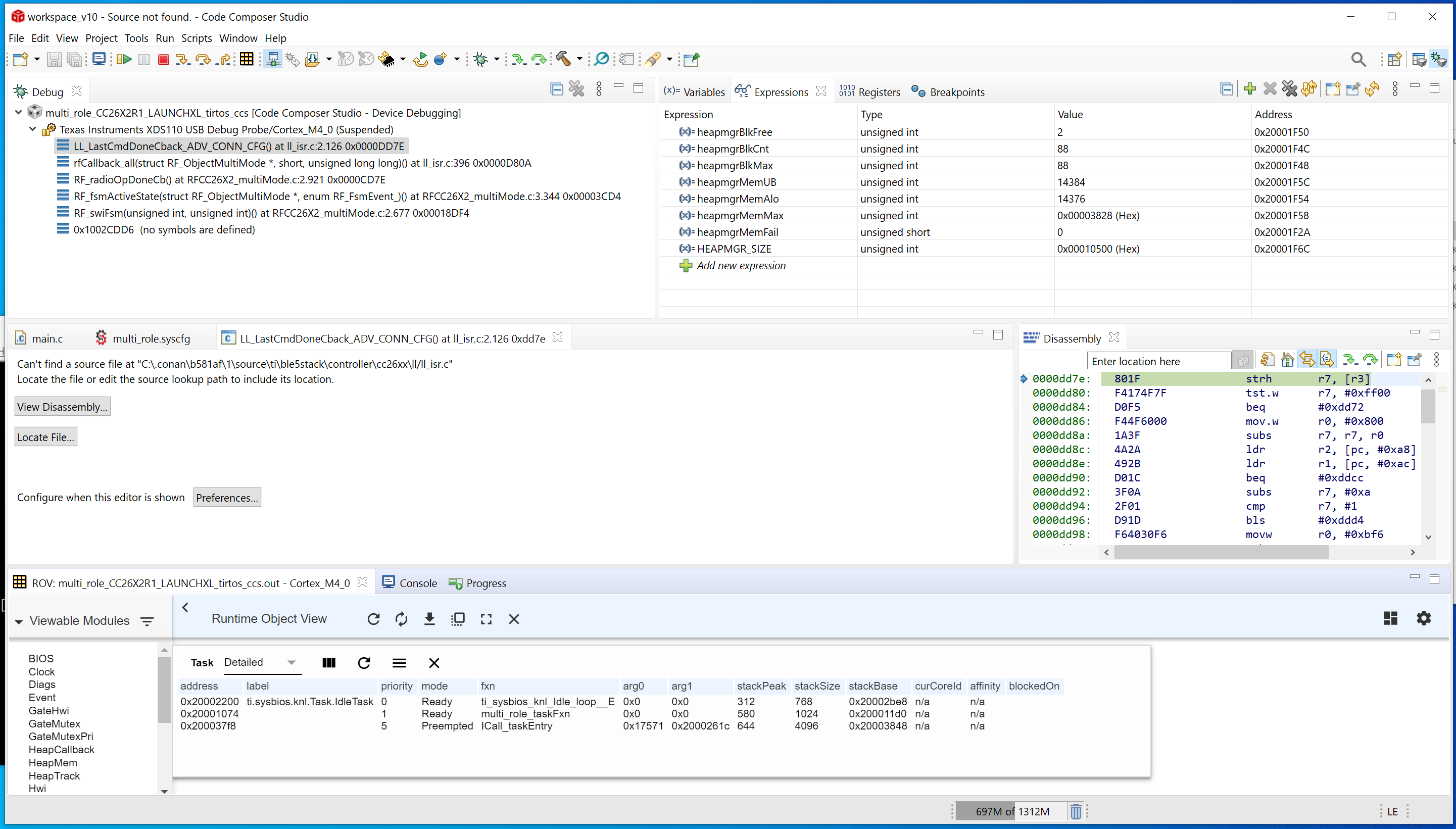

CC2642R: BugReport: ADV_CONN_CFG infinite loop if BondManager is updating while enabeling Advertisment
Part Number: CC2642R
Easy to reproduce with Simplelink SDK 4.20.00.34 and Launchpad CC26x2R1:
open multirole example project in CCS
open SysConfig settings for BLE and activate 'sync Whitelist with Bonded devices' (General settings)
and set filterpolicy in Advertisment set to ..connection from devices in whitelist
build the project and let it run.
connect with any smartphone and perform a bonding.
disconnect and reconnect several times, change the CCCDs of some Characteristics some times.
quite soon the controller will get in an infinite loop at LL_LastCmdDoneCBack_ADV_CONN_CFG().
As on a new connection, or after a disconnect, the advertisment is immediately reactivated. This
seems to get in trouble if the BondManager still is active to store Bonds or CCCD states.
Stacks and heap seems to be fine...
can you confirm this? Is there a fix / workaround available?
