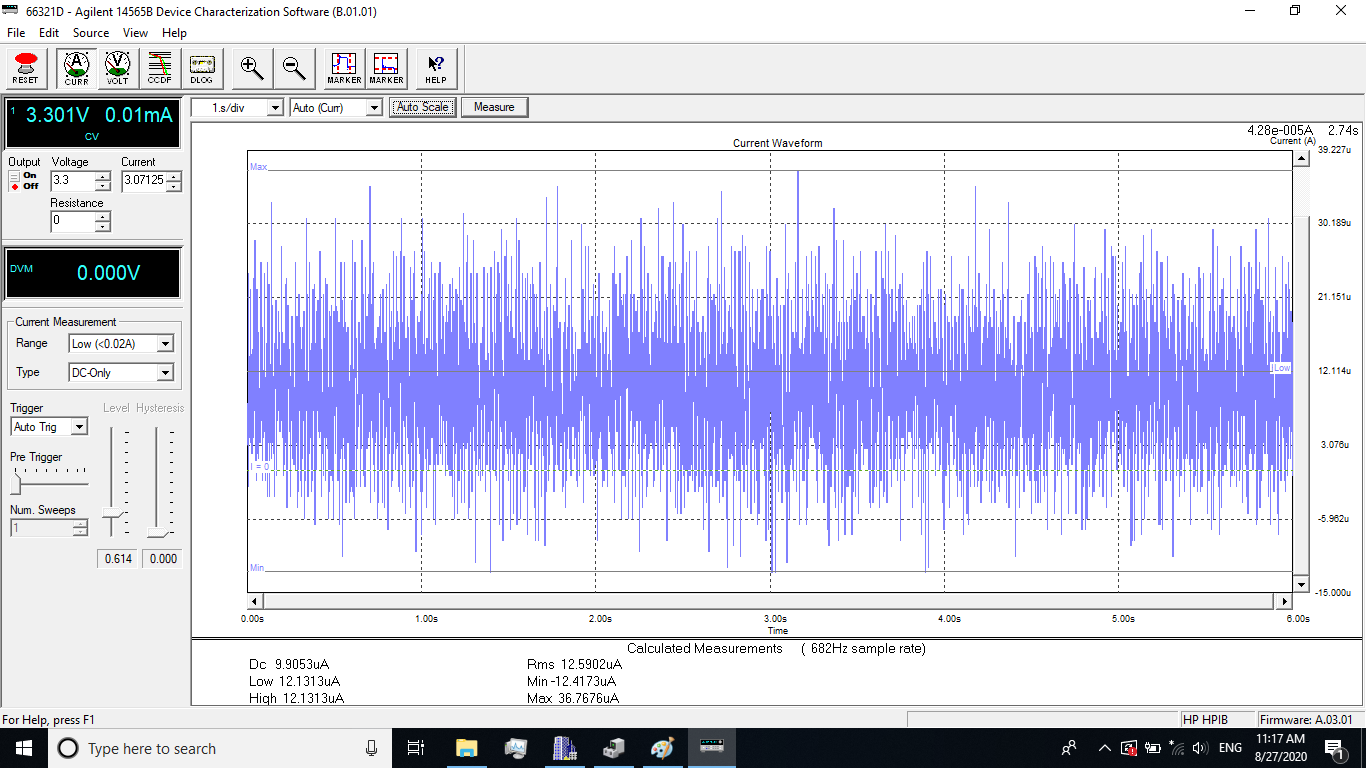

    I have refered to the pinShutdown example project. I have programmed the pinShutdown application into LAUNCHXL-CC1352R1 and measured the shutdown power consumption. Please refer to the following screen shot. The first one is active mode current measurement in pinShutdown application and the second one is shutdown mode current measurement in pinShutdown application. The measured shutdown mode current is not matched with the official document 150nA. Why? As to the power function API, I think I can use this Power_shutdown function API in application according to the pinShutdown example project. Thanks.
    Active mode current measurement:
    Shutdown mode current measurement:
    BRs.
    A few ideas that could help you:
    - is the external flash shutdown?
    - is the debugger / usb disconnected from the launchpad?
    - have you removed all the jumpers from your launchpad, except the UART RX jumper
    - have you turned of all the peripheral before shutdown? (call PIN_close(), UART_close()...)
    If needed, you can review one more time https://www.ti.com/lit/swra478.

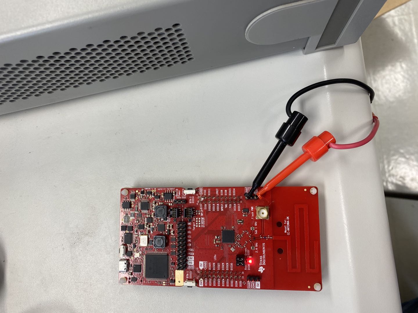

    These following screenshots are our test environment setup:
    The active mode current measurement:
    The shutdown mode current measurement:
    In the second screenshot, even if I remove the jumpers connected to the LED, the shutdown mode current measurement is the same. Thanks.
    BRs.
    Can you do the same measurement while holding the reset? (you will be required to put back the associated jumper)
    Can you, as suggested earlier, close all the peripheral (especially the PIN peripheral) before going to standby? You can add the following code (PIN_close(hPins);) right before  Power_shutdown();
    Can you o the measurement with a jumper between the contact written "RX<<" and "TX>>"? (This is to avoid having any floating pin)
    To finish, if all of this does not produce the expected power consumption, I will ask you to use an other launchpad in order to verify that not leakage is messing up the results.
