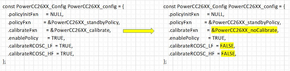

Configuration changes
Previously Power was statically configured as other kernel modules are, via the application configuration (.cfg) file. Now that Power exists as a TI-RTOS driver module, configuration follows the same approach as for other drivers. This is accomplished via a structure definition in TI-RTOS board files. Board files in the new TI-RTOS release (e.g., “CC2650DK_7ID.c”) include a PowerCC26XX_config structure, with these default values:
const PowerCC26XX_Config PowerCC26XX_config = {
    .policyInitFxn      = NULL,
    .policyFxn          = &PowerCC26XX_standbyPolicy,
    .calibrateFxn       = &PowerCC26XX_calibrate,
    .enablePolicy       = TRUE,
    .calibrateRCOSC_LF  = TRUE,
    .calibrateRCOSC_HF  = TRUE,
The default settings choose the aggressive standby policy & enable it via .policyFxn & .enablePolicy respectively (as shown above). RCOSC calibration is enabled by default, due to setting .calibrateFxn to PowerCC26XX_calibrate() & setting .calibrateRCOSC_LF & .calibrateRCOSC_HF to TRUE.
To disable calibration the following changes should be made to the structure:

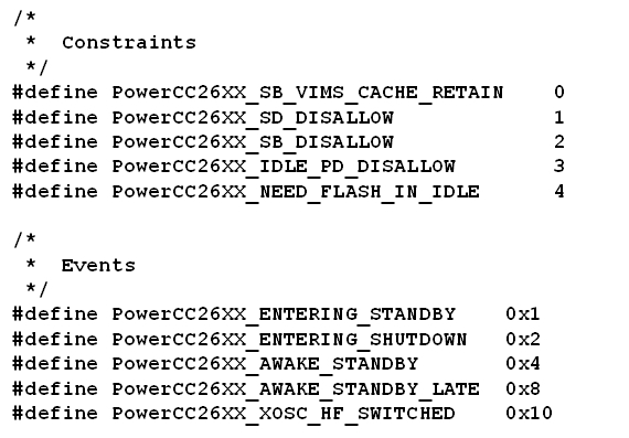

 PowerCC26XX resource identifiers
Similarly, constraints & power event identifiers now have a "PowerCC26XX_" prefix, as shown below (a snip from the new header file):

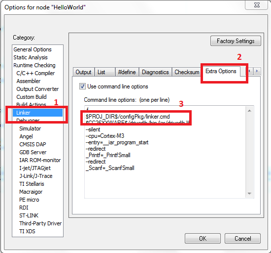

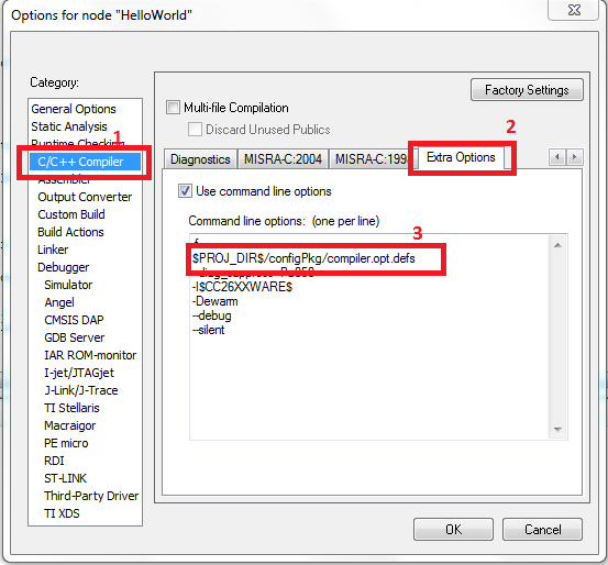

'configPkg' placement issue for IAR workbench users
  • When using IAR workbench, the generated 'configPkg' directory has moved in some project environments. Some IAR projects will have to be modified.
  • The 'configPkg' directory is now created in the same directory as the generated 'src' directory that is used to rebuild the kernel. The 'src' & 'configPkg' directories are placed next to the RTOS .cfg file.
  • This was inconsistent in the earlier releases. If the path to the .cfg file was specified using Linux forward slashes, the 'configPkg' directory was created correctly (in the same directory as the .cfg file). But, if the path to the .cfg file used DOS backward slashes, the 'configPkg' directory was created in the project directory $PROJ_DIR$.
  • This problem only occurs if the .cfg file is in a different directory than the project directory $PROJ_DIR$. This change should not be a problem for the common use case where the .cfg file is placed in the project directory $PROJ_DIR$.
    • Note that the examples provided with earlier releases of the project placed the .cfg file in project directory $PROJ_DIR$
  • If you are affected by this change, you will need to make 3 changes to your IAR project. You need to change '$PROJ_DIR$/configPkg' to '<path to RTOS .cfg file>/configPkg'
update the path to compiler.opt.def
update the path to the linker .cmd file
update the path to the package.mak file (this is needed for 'clean' & 'rebuild' to work)
