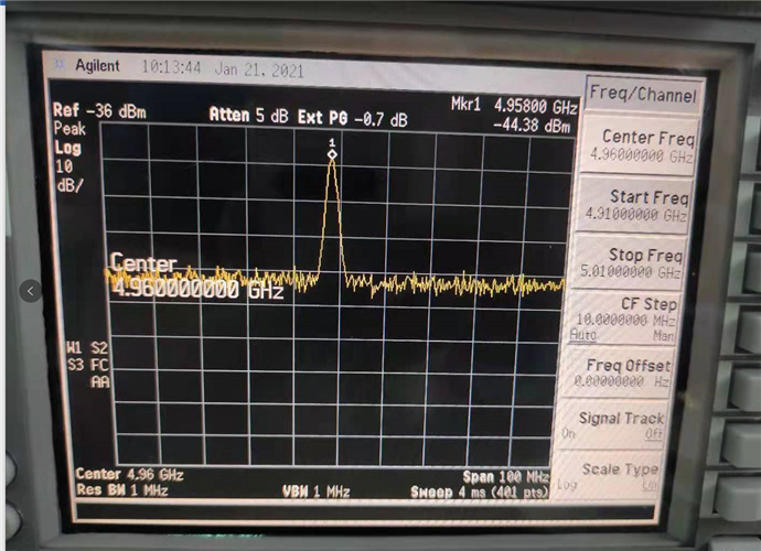

We met a problem of our module during passing KC certification. Pls see details as below:
Chip: CC2640R2FRSM
Reference design: TI CC2640R2F official one
Test method:
Module frequency: 2480 MHz
Spectrum analyzer frequency: 4958 MHz
Test Results:
Difference design: -57 dBm
Single-ended design: -42 dBm
The requirements of the KC standard is under -54 dBm.
The reference pictures
    Is this a conductive measurement or radiative measurement?
    Does the Spec ( -54dBm) for conductive or radiative?
    You mentioned you measured -57dBm in Differential mode and -42dBm in Single-Ended configuration. Is this correct?
    Are you using Single-ended or Differential mode?
    Why did you test in both modes?
    What is the Tx power you measured at 2480MHz in both Differential mode and single-ended mode?
    Did you copy our reference design?
    Could you please send your Schematic (PDF)  and PCB Layout (Gerber format)  for our review?

    We solved this problem yesterday. Thanks for your supports.
