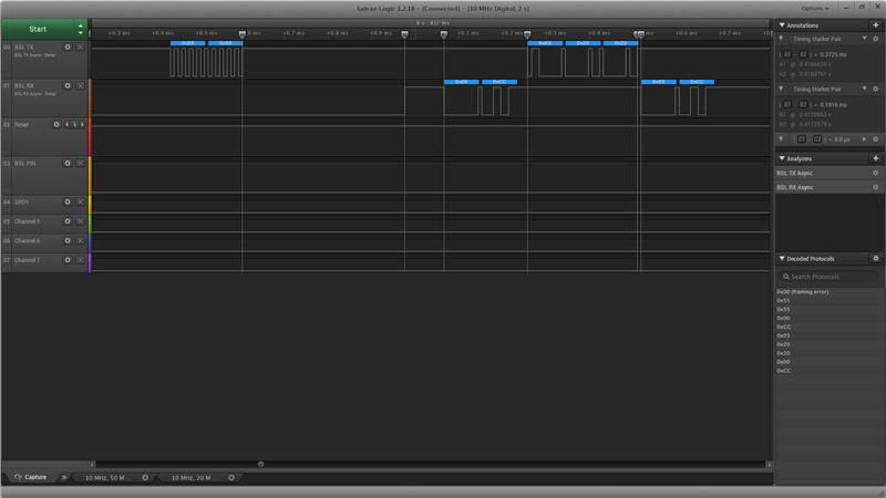

I have a CC2640 on a custom board that does not communicate after baud detection. The CC2640 is fresh from the factory and has not been flashed. I am using the UART serial bootloader (SBL). The code that I am using to flash the CC2640 successfully erases and flashes a BOOSTXL-CC2650 via the UART SBL and UART Rx and Tx pins (not JTAG).
After reset, the 2-byte baud rate automatic detection command 0x55 0x55 is issued and acknowledged with 0x00 0xCC, as it should. Next, COMMAND_PING is issued, and is "not acknowledged" with 0x00 0x33. From then on, there is no response from the CC2640 to any commands. This sequence can be repeated any number of times. I have also tried COMMAND_GET_STATUS, COMMAND_BANK_ERASE. I have tried issuing a dummy command 0x03 0x00 0x00 before and after the baud rate command; the dummy command is never acknowledged. There is no response after the initial baud rate command is acknowledged and the subsequent command is "not acknowledged" by the CC2640. Subsequent baud rate  commands are ignored until reset, as it should be. I have confirmed that the command packets are properly formatted. These exact same commands work properly with the BOOSTXL-CC2650 UART SBL.
On my CC2640 RSM package, the DIO3 SPI CS pin is driven high, DIO0 SPI DO pin is driven high and NRESET pin is driven high. All the VDDS pins have power and all VSS pins are grounded. There is no connection to the JTAG_TCKC and JTAG_TMSC pins. UART0 RX is connected to DIO1 and UART0 TX is connected to DIO2, as required for the RSM package. Communication seems to be established and the bootloader seems to be active.
I have tried various baud rates from 115,200 to 9600 without success after the initial ACK and NACK sequence.
I have carefully read the following literature and am complying with all requirements;
  • CC13x0, CC26x0 SimpleLink™ Wireless MCU Technical Reference Manual swcu117h.pdf
  • CC2538 ROM User's Guide swru333a.pdf
  • CC2538CC26xx Serial Bootloader Interface swra466a.pdf
  • CC2640 SimpleLink™ Bluetooth® Wireless MCU swrs176b.pdf
Please advise a course of action to resolve this issue. I am hoping this is a symptom of a known issue.

    Do you have a log or a logic analyzer trace that you can share with us (successfully and failure sequence)?
    Probably you did this already, but could you please also monitor the reset line on your custom board and verify that you are not getting a reset between the BAUD and PING commands.
    I'm trying to locate a board with the RSM package so I can run a few tests on my side, I'll keep you posted with my results.
    David
  • Hi David,
    Yes, monitoring the reset line is a good idea. I monitored the reset line and I have not been able to detect the slightest change in voltage. The reset line stays solid at 3.2V.
    Here is a log. Commands sent and received are verified by a protocol sniffer.

  • Hi David,
    I removed the reset command between successive groups of pings. Here is the log:

  • Hi Dennis,
     Unfortunately I have not had any luck reproducing this behavior. I capture the following screenshot from my logic analyzer.
    So at this time I have more questions:
    1. Is it possible for you to take a similar screenshot with your HW?
    2. Also, would it be possible to get a copy of your schematics? Please send me a private message with your contact information (you can click on my profile and send me a private message that way), and I will contact you offline.
    3. Do you have access to the JTAG pins? I do not think this the case, but I just want to confirm this. I'm trying to confirm that your HW is functioning properly. Have you followed the tips from this HW Troubleshooting: http://processors.wiki.ti.com/index.php/CC26xx_HW_Troubleshooting
      David
