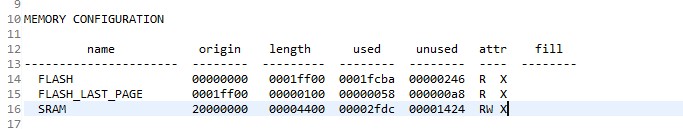

After several times of connection to a slave device of CC2640R2F by using mobile APP, it failed to read out the list of services from the slave device. Error Code: Insufficient Resources (0x11) by grabbing the packet.But
this error occurs only on some phones.Please help to analyze the reasons and optimize them.

    You should enable HEAPMGR_METRICS in your project to watch the amount of memory available as you are likely running out of memory. See related post here: e2e.ti.com/.../794010
    My project based on BLE5 stack,and the issue occurs in Huawei mobile phone with Android 10 OS,others maybe,but vivo with Android 10 OS worked,iPhone is also running well.When the issue happened,keeping the power on and don not restart it,we just connect  to the slave device with other types of phones,but it worked successfullly and getted the complete service of slave device.Therefore I do not  think the slave device is Insufficient Resources.
    this is the information of flash and ram

    From the sniffer log provided, it appears that your iPhone is sending a read by type request before you receive the status insufficient resources response. When the slave device receives a read by type request, it will build a read by type response message with the function gattServApp_buildReadByTypeRsp. This function will return the status insufficient resources if it fails to allocate space for the handle and value pairs.
    If possible, can you connect to the slave device and monitor the heap by using the HEAPMGR_METRICS as described by Ammar? The following link describes in more detail the HEAPMGR_METRICS variables you can view: https://dev.ti.com/tirex/explore/content/simplelink_cc2640r2_sdk_4_30_00_08/docs/ble5stack/ble_user_guide/html/ble-stack-5.x-guide/debugging-index.html#debugging-common-heap-issues
    I do see that you were able to connect another device and actively get the complete service successfully. Can you constantly monitor the heap metric variables and see if it's fluctuating between when you get this insufficient resources status and when you test another phone?
