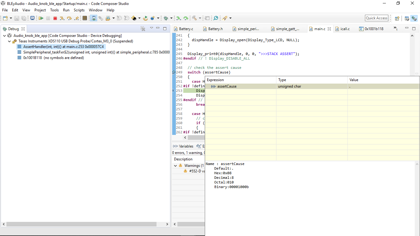

    As you are reaching the AssertHandler() function, we should be able to understand the cause of your issue. It would be nice if you could disable the code optimizer and see if the assert cause can be identified (it is usually not possible with the code optimizer enabled). If the code optimizer cannot be disabled, within the AssertHandler() function, try to set two volatile variables with the value of assertCause and assertSubcause.

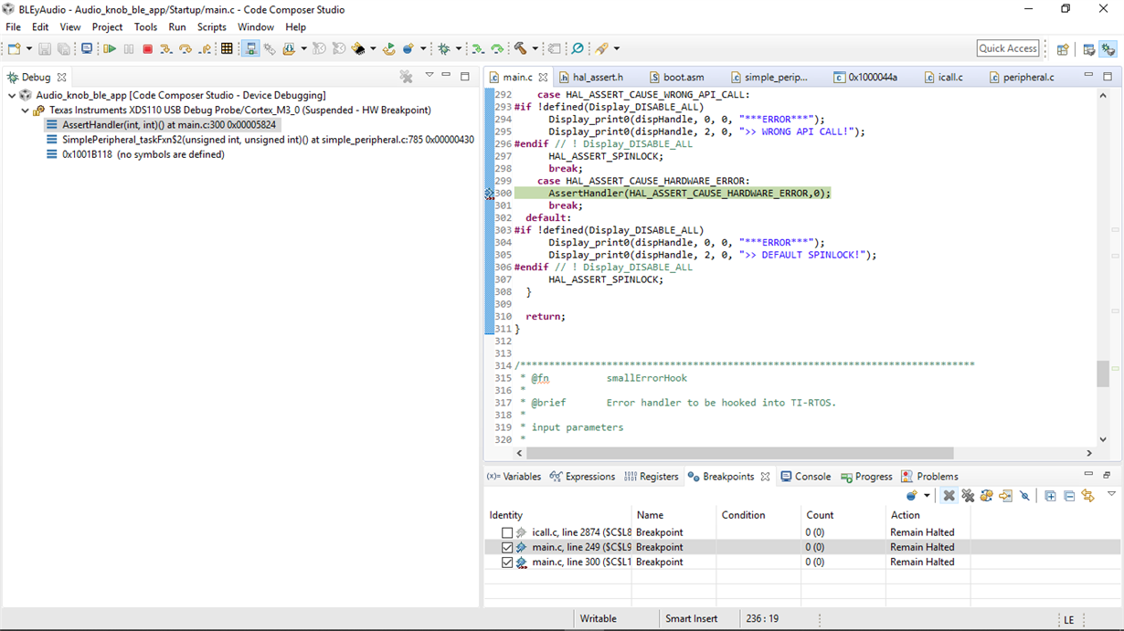

  • Hi Clément,
    Thank you for your response. We are using CC2640R2F, please find attached the images with the experiment you suggested.
    If you can help me identifying what is happening, I will be very thankful.
    Best regards
    The error handler seems to be caused by HAL_ASSERT_CAUSE_HARDWARE_ERROR.
    Based on this, I think the following code is causing this:
              case HCI_BLE_HARDWARE_ERROR_EVENT_CODE:
                AssertHandler(HAL_ASSERT_CAUSE_HARDWARE_ERROR,0);
                break;
    Could you set a breakpoint in this specific piece of code and see if you could get further insights?
    By the way, I only used the first image you have attached. I am not sure what you wanted to show with the two others. Don't hesitate to point me to something I haven't seen.

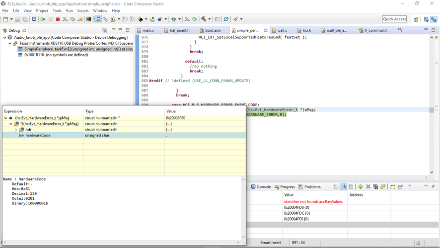

    Actually, I can say for sure for the moment.
    This event is forwarded to the BLE host layer from the lower layers of the stack (HCI, Controller).
    The cause of this error can be accessed in firmware via the hardwareCode field of the hciEvt_HardwareError_t struct that is sent alongside the event.
    I would recommend parsing the hardwareCode in SimpleBLECentral_processStackMsg(...) under the HCI_BLE_HARDWARE_ERROR_EVENT_CODE.
    Cast the  pMsg to (hciEvt_HardwareError_t *) and read out the hardwareCode.
    The associated error codes are defined in the following files: ll_common.h and hci.h.

  • Hi Clément,
    Sorry for the late response, yes, I've finally got the error code. Error code is 0x81, so I assume that it is HW_FAIL_OUT_OF_MEMORY, as shown in common.h
    Is it possible that we have not enough memory for this characteristic? If that is the case, what should we do for allocating some bytes of memory for a new BLE characteristic?
