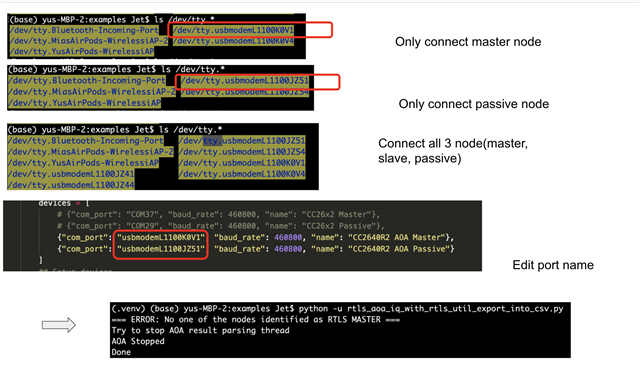

How can we get  IQ data on AoA board on Mac OS? I got everything set and the GUI tool work well, but when I run the
python -u rtls_aoa_iq_with_rtls_util_export_into_csv.py
Error show the port name is wrong. Could anyone help?
