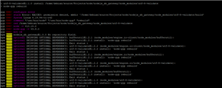

3rd  issue, I tried to start the gateway with CC2531 or LAUNCHXL-CC1352P1 and see those errors bellow:
 the shell shows the errors bellow:

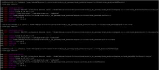

I believe that my 3rd issue have relation with the installation procedure, during setup script. I found those erros during a new attempt to fix it during setup.
ERRO detected during the setup script running.......
...   ERRO detected during the setup script running.
I went to check the 1st setup error presented at beginning :
And I dind´t find the rest of the path inside the directory ... I cant find the /bufferutil or /bufferutil/build or utf-8-validate!
Somebody can help me, please?
