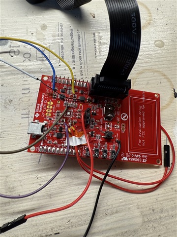

I also tried to remove an RF430FRL152H chip from an evaluation board and to hand-solder wire by wire the following pads: 1.5V, GND, TDO, TDI, TMS, TCK, RST
to our connector. I'm attaching here a couple of pictures for your reference:
Many thanks for your help
    Can you probe all the signals (TCK, TDI, TDO, TMS) on the original Launchpad vs. the one that has the RF430 depopulated? Can you also probe the VDDSW to the transponder? Do you measure 1.5V? Please also check the RST/NMI input to the transponder. Is it out of reset?

    About the second attempt, it's a different test.
    I picked an EVALUATION BOARD that was working and flashing my program properly. Then, I just removed the RF430 chip and soldered some cables on the right places. I also checked the continuity of the signals by looking at the RF430 diagram to ensure all the connections were correct.
    Then, the flying cables are going straight to another connector compatible with the J1 JTAG connector.
    I checked VDDSW in output of the Evaluation board and is 1.5V. I can check the other signals in the next days.
    I still don't understand why it wouldn't work. Please check that VDDSW (1.5V) is supplied to the RF430 and the NRST/NMI pin is HIGH to release RF430 out of reset. I will also suggest you do a sanity check for your custom board with the transponder. Without supplying power to it, it should still work over RF when a reader tries to read it. Does it even work?

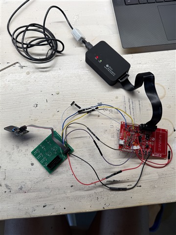

    Just to be sure, I also assembled a minimal board with just the tRF430 transponder and some capacitors. Here you can see the picture. In this case, I checked the continuity pin-to-pin of the wires. To achieve that, I checked the continuity between the RF430 footprint of the evaluation board and the exposed pins of the RF430 soldered on my custom board.

    Since we're currently still using the EVALUATION board (like in the last image) to try to flash the chip, I think that the NRST_IN should already be in place.
    MSP-PROGRAMMER > EVAL > WIRES > CUSTOM BOARD
    PS: Is there a programming adaptor for these kinds of devices? Maybe it can be easier
  • Since we're currently still using the EVALUATION board (like in the last image) to try to flash the chip, I think that the NRST_IN should already be in place.
      That is true if the TRF chip is still in EVM board. I thought you removed the TRF in the original picture. Without the TRF in the EVM, the NRST_IN is tristated.
