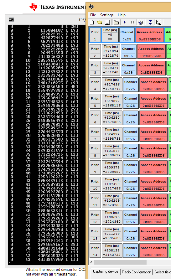

  • What is the required divisor for CC2540 when sniffing Bluetooth Low Energy packets using 2.16.3.0?  The closest number that I've found is 419.43!!!  But that number does not work with all 'timestamps'.
    Here is a screenshot with the raw values (LSB first, I know) and with the TI Sniffer's interpretation:
    This is the code that I'm using to parse the .psd file:

  • The time stamp format for the CC2540 sniffer is a bit tricky. Here's what you need to do:
    uint64_t timeLo = rawTimestamp & 0xFFFF;
    uint64_t timeHi = (rawTimestamp >> 16);
    uint64_t timeStamp = timeHi*5000 + timeLo;
    uint64_t timeStampUs = timeStamp / 32;
  • Hi M!
    I can confirm that the formula works.
    Here is the updated script, just in case it might be useful to somebody:
