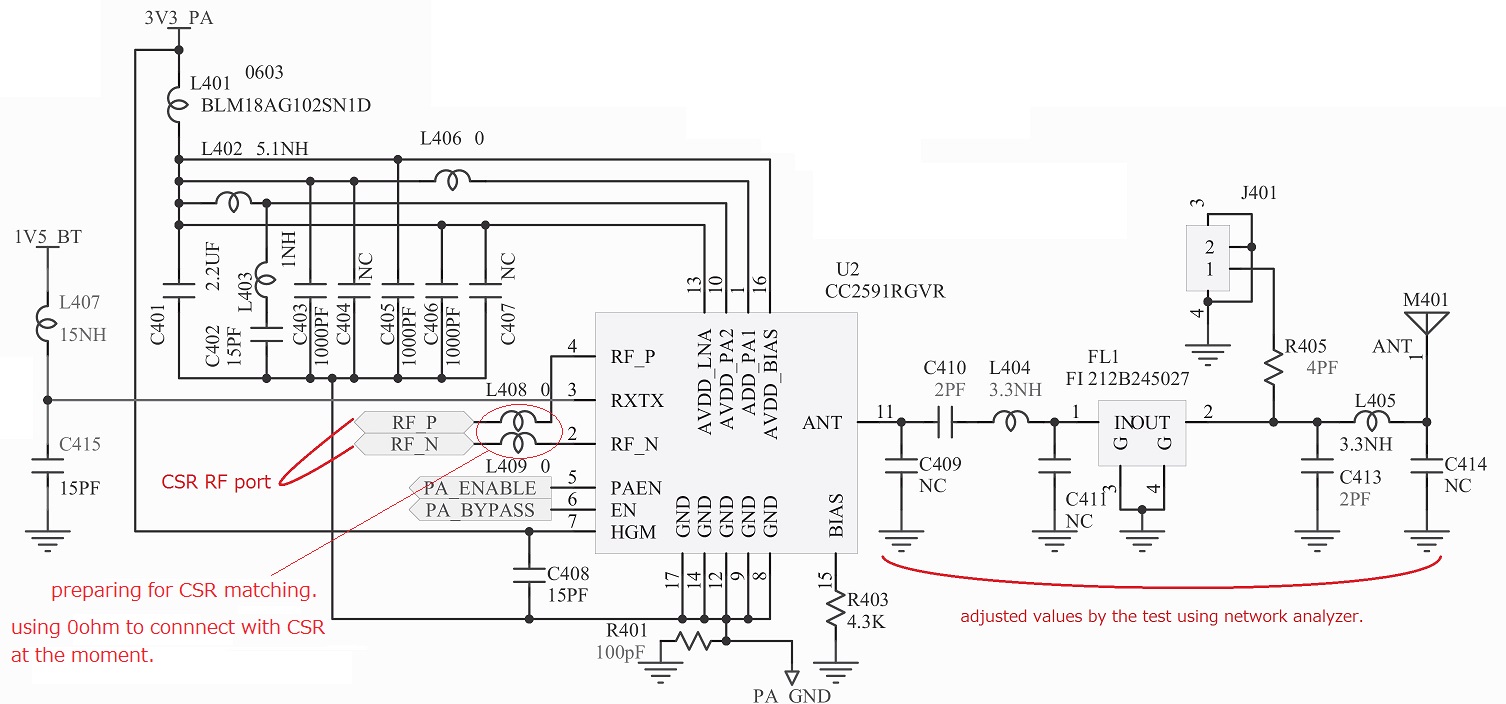

we are study the system CC2591 + CSR BC57E687C (BC5) for class-1 now.
I want to know matching methods of these chips.
When connenct these chips directly, the loss of signal about 2~3dB is seen.
About CC2591, I can see the impedance information in this site.
But, CSR cannot disclose the impedance of BC5 RF port.
About those RF connection, please advice me what kind of the matching circuit and values are most suitable.
Thank you.

    When you say "loss" what does that mean. Are you talking about TX output power or LNA gain? Also can you share the schematic, or at least the portion of the schematic pertains to the CC2591.
    /TA
  • TA san,
    Thank you for the comment.
    "loss" mean, I'm talking about TX output power at BPF (FL1) out.
    and currently schematics are as attached.
    L408 and L409 are reserved for matching with CSR BC5,
    If some of these value (L or C) makes matching better.
    Thank you.
  • - The output impedance of the CC2591 change when the impedance on the input change.
    - The impedance on the AVDD_LNA, AVDD_PA1 and AVDD_PA2 lines are important
    - You need to run load-pull at the CSR output to know the optimal load impedance. Second guess is that the output is 50 ohm and you can tune from 50 ohm to CC2591 required impedance.
    - Please check the connection to pin 3.

  • I don't know about any designs which uses  CC2591 with a non-TI chip. This is normally fairly complex and the support we can provide on this is very limited. Try CSR with balun to 50 ohm and then 50 ohm to the CC2591 input.

  • I recommend follow an existing and verified design in detail, if you not is prepared to measure/design your own impedance matching circuit. My experice is that it is too easy to else fail and more or less not getting any system improvement with circuits like CC2590-91.
    I design impedance matching circuits including CC2590 regularly, maybe 4-5 times each year. Sometimes feed by CC2500 and sometimes something non TI. It is always nice to know manufacturer measured impedance for these chips but at these relative high frequencies plays also PCB and transmission lines a big role for total impedance. Even if transmission lines are well designed do they add a delay and chip impedance is then of little value for calculating an impedance matching network. Measure with a VNA, via a differential probe at point for the network both against CC2590 and against the source chip. From that is a L/C network calculated with aid of an automatic impedance optimizing software (AnTune) which takes account of L&C S-parameters.
    Often forgotten are taking in account importance of matching or mismatching for harmonics. It can be of very high importance for some  types of PA stages behind CC2590 to get high efficiency and low harmonic levels.
