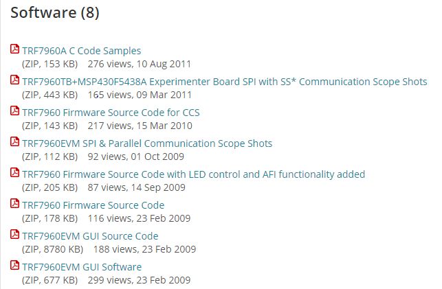

  • Are we right doing the assumption that the TRF7960A EVM does not allow MSP430 programming?
  • Is it possible to find the source code loaded into the MSP430F2370 implemented on the TRF7960A EVM evaluation board? Can it be read using the MSP-FET?
  • Using the TRF7960A Target Board, we assume that loading our own program into the MSP 430 memory will erase the original TRF7960 communication stack implemented. Is there a way to revert to factory settings?
  • In other words can we upload what is originally implemented in the MSP 430 to save and restore it?

    1. You can program the MSP430F2370 by using an MSP-FET JTAG Programmer and Code Composer Studio or IAR Workbench (All our code examples are for Code Composer Studio)
    2. You can find the source code the TRF7960AEVM on the EVM's tool page near the bottom: http://www.ti.com/tool/TRF7960AEVM (Click on "Show More")
    3. Yes loading your own program will erase the original TRF7960A stack, but you can revert it using the firmware examples mentioned above.
    4. You can use the original firmware examples, modify them for your application, and then program the MSP430F2370 that way. This can be done with any of our provided example code including the newer software example I mentioned at the beginning of this post.
    5. Yes, the EVM is configured so that JTAG and MSP-FET is the only way to write firmware into the MSP430F2370 on the TRF7960AEVM
