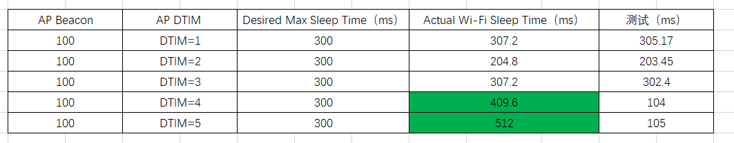

  • Hi zx,
    If the DTIM interval is longer than the requested LSI - then the LSI is not relevant because we will anyway go to sleep for more than the request (DTIM=5 -> we will wake up every 512 ms).
    In your measurements, it seems that there is no effect to changing the DTIM which is very strange and I'm not aware of such issue. In addition, the value of 204 doesn't make sense for any DTIM values other than 2 & 4.
    Please make sure that the DTIM interval was really updated?

    Hi  Kobi,
    Thanks a lot.
    I had recheck my code,
    In the code of Powermeasurement,when i used UDP mode, it seems can not capture the Beacon(but i donot know what happend),which make the data show in above.
    Now i changed to TCP mdoe ,the data (DTIM interval <LSI) follows your explain,but still there were something wrong with the data(when DTIM interval >LSI)
    The data of  most right column is the  wifi wake up interval(ms) time.
    I had still try to get the relationship between LSI and  DTIM interval (when DTIM interval >LSI) ,whether you advice a code (from the CC3200SDK_1.3.0)? thanks.
