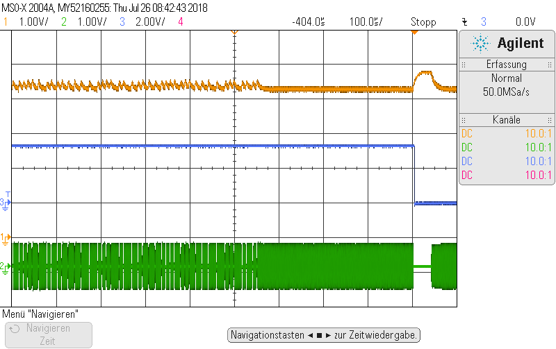

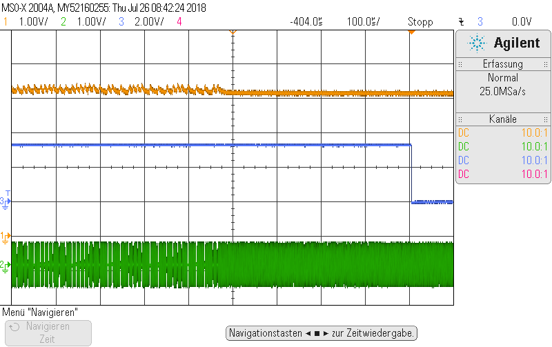

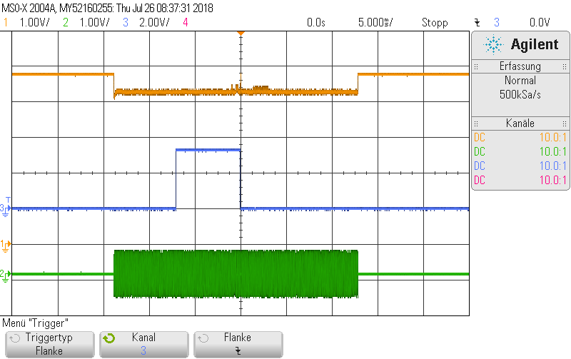

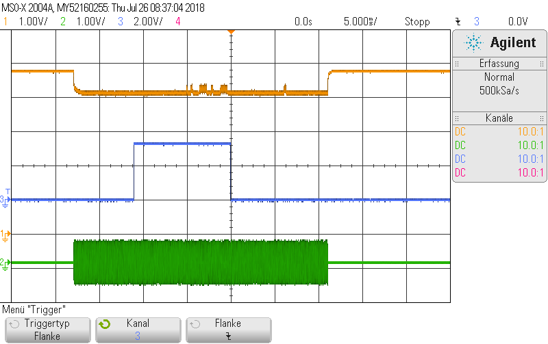

    please see following pictures from VDD_RF for both cases: on good and on bad performance.
    Orange line is VDD_RF, Green line is radio signal (measured on an antenna), blue is just a trigger signal.
    1. reading good, whole sequence
    2. reading good, zoomed in
    3. reading bad, whole sequence
    4. reading bad, zoomed in
    We tried out all voltage levels, also VDD_RF = 4.3V. The error disappeares completely only if we set 3V operation.

    Reviewing your waveforms, it looks like there is a spike on VDD_RF when your trigger signal falls, and that spike causes a break in the RF field output more notable than just modulation. That could possibly explain the read failure.
    Are you issuing the same command in both cases?
    Can you describe what you are tracking with the trigger signal?
    On another train of thought I had would be if have you done any monitoring about the current draw for your system? Given it works with 3V settings, I had been thinking that it could be that the 3V settings are drawing less current in and that is why it is successful, but then half-power would work too... after all, it should have a max draw of 78mA vs 100mA for 3V. That said I'd still like to understand if your current supply is providing enough energy, and also if the failed behavior on half-power mode identical? In other words, do you see any notable gaps in the RF field due to the VDD_RF spikes in that situation as well?
  • Hi Ralph,
    to your questions about colleration between spikes, trigger signals and command sequence:
    - test trigger signal rises directly before we start reading the transponder => send first command "REQA"
    - test trigger signal falls directly after we've done reading UID (whatever the result is). If the reading attempt was unsuccessful, we turn off the radio field and start after a short delay next attempt.
    So, the one bigger spike at the end of last diagram (see above) is not the reason of the problem, but the result: we turn off the field and VDD_RF goes high. The error happens earlier.
    Yes, there is the same command sequence in both cases: REQA and anticollision loop.
