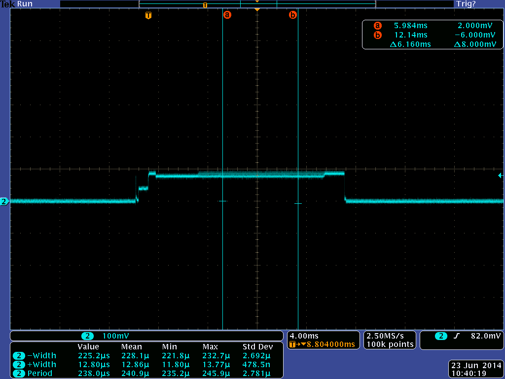

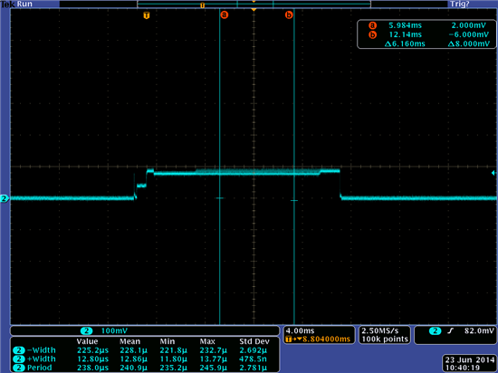

Im trying WOR application with CC2500. in first picture I set up RX time and Sleep time well. When there is RF Signal on air second picture is showing how my card is behaving. Just I dont know how to take data. its just staying in rx mode longer but nothing happens.
Picture 1.
Picture 2.
    Are you sure that you have the correct settings for the transmitted packets? The radio should behave in almost the same manner after the reception of a packet as if as if you used the RX commands strobe. Can you use smartRFStudio to test the settings in a packet error rate test without using the WOR implementation?
    BTW: Have you read AN047 - "CC1100/CC2500 - Wake-On-Radio" (http://www.ti.com/lit/swra126).
    Yes I read it and without WOR mode it works well. I dont know how to get data when CC2500 is in WOR Mode.
  • It should be in the same way as without WOR.
  • I just realize something. Firstly my configuration is like that about WOR
    SPIWriteReg(MCSM2 ,   0x0E); //MainRadio Cntrl State Machine --- 12
    SPIWriteReg(MCSM1 ,   0x3f); //MainRadio Cntrl State Machine
    SPIWriteReg(WORCTRL,  0x08);  // WORCTRL
    SPIWriteReg(WOREVT1,  0x45);  // Uyku suresi bu sekilde 0.5 SN
    SPIWriteReg(WOREVT0,  0x00);  // Uyku suresi bu sekilde 0.5 SN
    like this when I dont send even SWOR Strobe CC is not working normal. but if I will change WORCTRL on 0x88 it works well but after SWOR CC is going deep sleep. Nothing can change anything.
    What should I do ?
