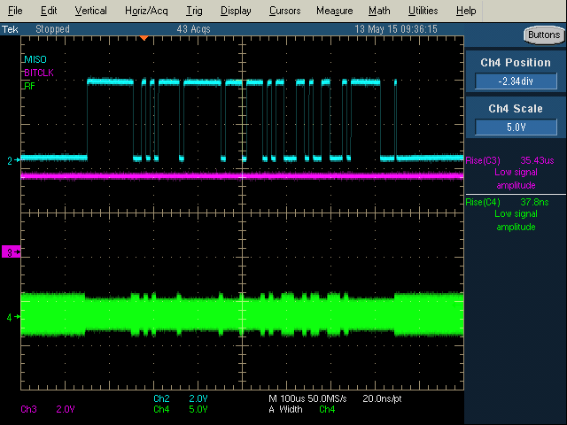

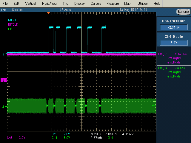

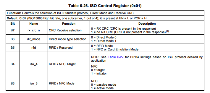

  • Hi John,
    I've tried to receive with CRC bytes by making B7 in the ISO control register high, but I'm not getting them. Also, the footnote in the datasheet says: "Only applicable to ISO-14443A and ISO-15693".
    Also see the attached file from my logic analyser (iso14443b with ISO control bit 7 high but no crc.logicdata, captured using Saleae Logic 1.1.34): at the first bookmark (1.7329692s) I read the fifo status register, which tells me that 3 bytes have been received. At 1.7330332s I read the ISO control register, to check, and it shows that the bit 7 of the ISO control register is still high.
    The data I receive is 0x05 0x00 0x08, which is the WUPB from my terminal, without CRC. If it would have a CRC it would have been 5 bytes: 0x05 0x00 0x08 0x39 0x73.
    So to me it looks like receiving the CRC for ISO14443B in direct mode 2 is not possible.

  • the footnote is correct. All Type B commands are sent and received with CRC, so the part always generates if for you on (downlink) and then checks and strips out on uplink (RX)
    Type B does not use parity, so not sure where you are going with that, unless its about Type A.
    please advise.
  • > Type B does not use parity, so not sure where you are going with that, unless its about Type A.
    My bad, I'm still learning and assumed type B had parity as well.
    Anyway, for type B I'd like to receive the messages from my terminal/cardreader with the CRC, so I assume my best option is to use direct mode 1, right?
  • got it - so question back here is why you want to see the CRC... the built in the CRC generator/checker was done on purpose to lighten the firmware load - so it will not give you anything back if its not correct except for CRC error or data corruption error in the IRQ status register.
    otherwise, if you absolutely require having a look, then DM1 or DM0 will be your path to get it.

    As for the code, I would try 2 things:
    1) Put a short delay (1-5ms) after the idle command.
    2) Set ISO_Control to 0x61 instead of 0x65
    With the ISO_Control register set to a 0x21, the TRF7970A actually decodes all commands in a sniffer type mode. Typically when doing Card Emulation we always start in this mode and listen to the different commands received. We typically also reset between each command.
    Give this a try in Direct Mode 1 by setting the ISO_Control to a 0x61 and see if you see any commands.
    JD

    No problem, I'm grateful for your (and Josh's) assistance. (And I completely understand the "Why does anyone care for the CRC?" :) )
    I've tried your suggestions: I've put a delay of 5ms after the reset and idle command and changed the ISO Control register value to 0x61 in step 16 (and in step 3, just to be sure) . Result: nothing :(

    For a sanity check: When I use direct mode 0 (0x21 in the control register) I see the bits on the MISO line and when I look on the oscilloscope I see they match with what the reader sends, both the type A and type B. So that (still) works. I just don't get the bitclock when I use DM1.

    Do you have more suggestions?
