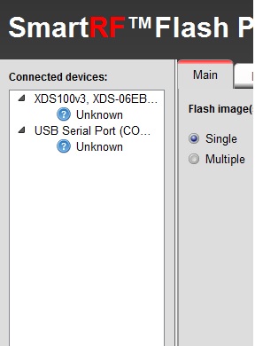

6. CC2538 OTAClient was dead and SmartRF Flash Programmer2 cannot find device and IAR Workbench popped up errors shown as below:
My question is Why Flash Programmer 2 and IAR cannot find my device and how I can fix this issue.
