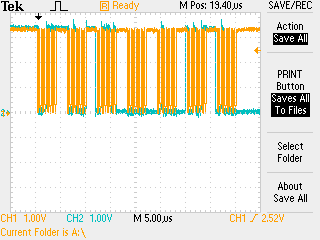

    After that comes ISO14443A_sendAnticollisionCmd function. After rawWrite[0x8F 0x90 0x3D 0x00 0x20 0x93 0x20] it comes TRF79xxA_waitRxData and here is where I stuck. There is no interrupt/response from TRF after AntiColl command. Tried different rx/tx timeout configuritations for TRF79xxA_waitRxData,
    Here is oscilloscope data for sending anticoll cmd, Yellow-clk, blue-miso:

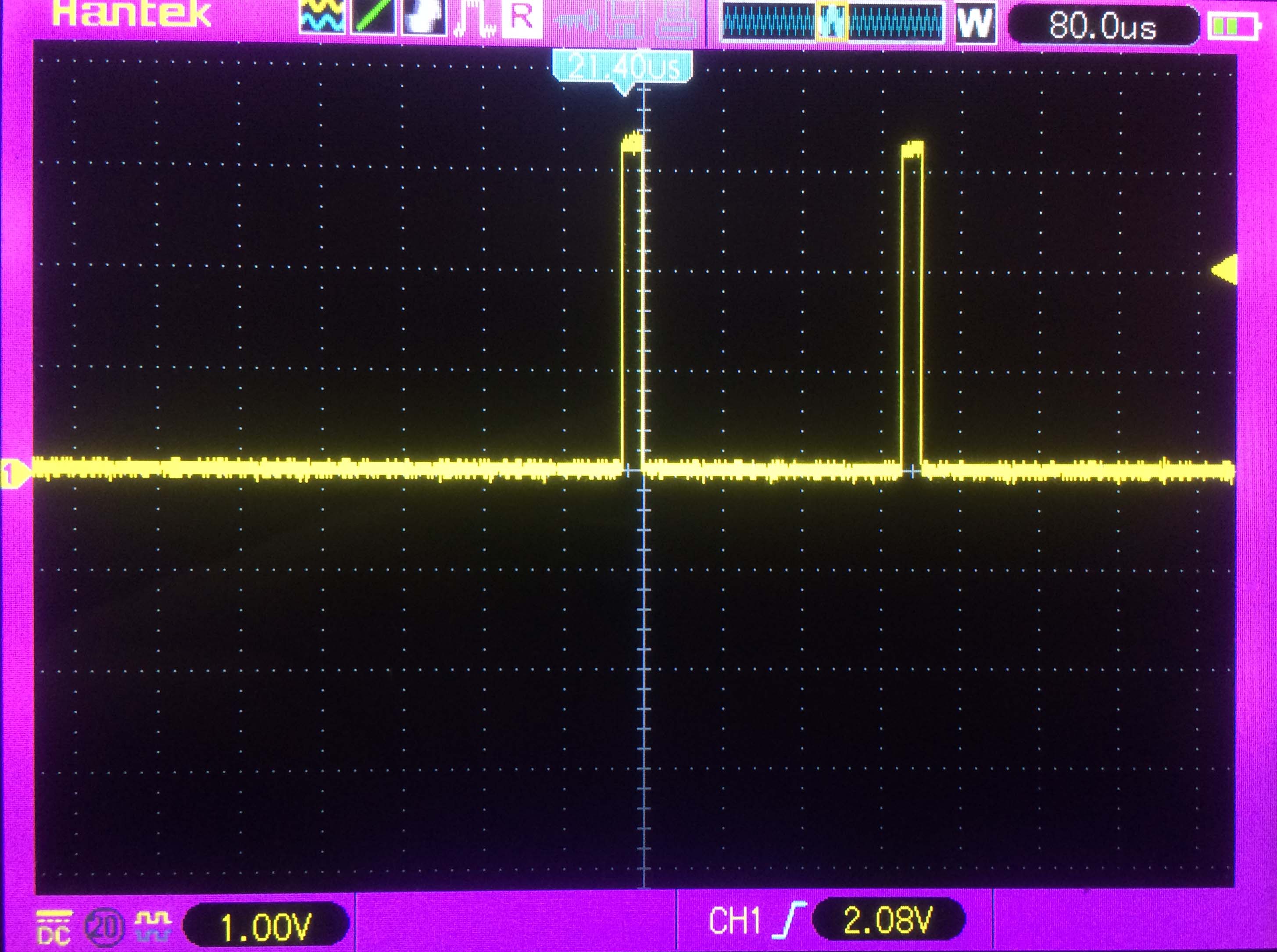

    So I get only two interrupts on IRQ pin while findTag loop (if there is card in field):
    If there is no card - one interrupt.
    So, can you please tell, what can be the problem now? Why there is no response after AntiColl cmd?

  • Hello Demian,
    That you get two interrupts with a tag and one without a tag sounds like the correct behavior. The interrupt you always get is for the TX Complete, and then it seems you get some sort of RX interrupt when you have a tag present. What would be important to know now would be what the IRQ status from that second interrupt is, as it would indicate if there is received data or if an error occurred.
