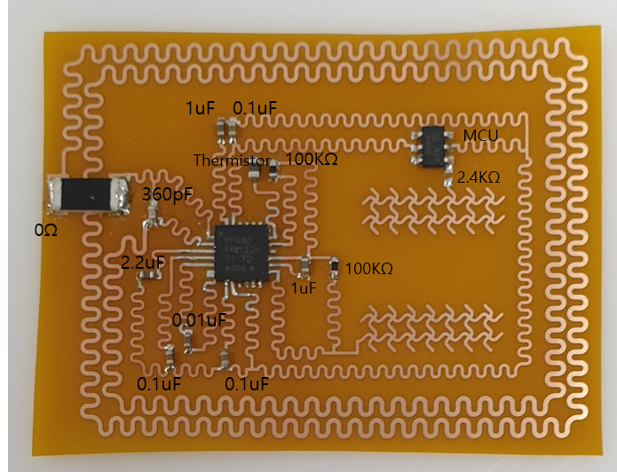

  We made a circuit for reading temperature and GSR. We faced some problems using the NFC reader and mobile application which we made.
1. The NFC reader didn't read our circuit.
  We wrote source code at Matlab based on your RF430FRL152H Gui interface, but it didn't work. here's our code.
Pls, figure it out the code problem.

2. NFC chip doesn't work after reading mobile application.
  Because of the problem at NFC reader, we used the Android mobile application which we made for reading temperature and GSR data.
At first, everything was good, after several measurements using a smartphone, it didn't work.
Therefore we changed the NFC chip, it fixed but it was not working soon.
We guess something wrong in our circuit. Here's our circuit.  Could you tell us the reason why the NFC chip broke too fast?

  • Hello JooHo,
    as you wrote your code works a few times it does not seem to me that there is a software problem.
    When looking at your PCB I wondered at first about the shape of the traces but I assume due to the fact that it is a flexible PCB, you what to avoid broken traces when the PCB is bend.
    What happens in this case, is that you have very long traces. When it comes to the GND connections this is very bad. All the caps should be placed close to the device and the GND connections should be short with low impedance which means also thick traces.
    If you have the EVM board available and your software works with the EVM then, for sure, your PCB design causes the problems.
