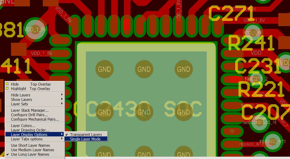

  • Hello
    I opened the file and overall it looks very good. Here are some comments; some of these may be the difference in how it opened in my configuration of Altium:
    Right click on MonitorSensor.PrjPCB in the left panel and add Existing files  MonitorSensor.SCHdoc and MonnitorSensor.PCBdocas well as the other schdoc files so they become sync'd and stay sync'd.
    In Stack up Manager the total board thickness is 1.3" or 34mm, could be a decimal point is missing on the middle layer.  The way you have it (core - prepreg-core) supports blind vias  but adds expense. It also does not provide as good of a ground plane or thermal performance.  Most quick turn board shops use a single board as a core and form the top and bottom layer with prepreg. I've used this with the CC2430 with good results.  As defined you have two cores separated by prepreg. It gives you better thickness consistency and is thicker, both help with the RF design and performance. In the pull down in Stack up Manager you can see the difference.  Key is to find out what your board house has and what it costs and then use those parameters.
    All vias should be set to go from top to bottom, not top to GND. This includes the ones under the devices. Right click via, properties and fix each one. There may be a global command but I have yet to find it.  The via attachs to the appropriate inter layers as they pass through. The GND vias shitch the top pour, inter ground layer, and bottom pour together causeing each to appear more continous.
    The bypass caps are too far away from the pins, same for the caps on the HF XTAL.  There could be a few more bypass caps. The wiring should be VDD via  - wire  - cap  - pin. Think of the bypass caps as a gate across the road, not off a side street some distance from the main road.
    Add a 100pF to .1uF cap from the /RST line (pin 10) to ground, leave off when first using Ti programmer. You will only need this when the device is fully programmed and ready for use away from the programmer. Without it noise will occasionally cause a reset.  Also the cap and R101 causes the /RST (not reset)  to rise slowly allowing the main power to approach full value before /RST become high enough to allow the device to operate. This prevents the device coming up in some funky state on occasion.
    You do not need the pull ups on the unused ports. They default to inputs with pull-ups after a reset (i.e. turn on). (Data sheet page 77 of 211) To be sure I include a few lines of code to do this as well.
    The board must extend under the antenna, replace the "Plane" with a "Layer" in stack up manager and then place a poly fill over the area not including the antenna. You may want to do the same for the layer 3 power plane. This will permit you to define a separate 1.8v and a 3.3v power plane if desired.
    I suggest adding another 2x5 header like P8 and route the SPI pins and maybe a couple of unused  I/O pins to it as a test port.  You may, or may not, have access to a logic analyzer today but if you continue with this type of project you will. There are several good ones for $150 to $390. The ability to "see" the 4 SPI in action and a GPIO port thrown in so you can see when a code point is passed really helps during development.  Even the abiltiy to hang a scope on it to see SCLK helps. It will save many hours of try this, try that.  Here are two I like  http://www.saleae.com/logic/ and http://www.pctestinstruments.com/

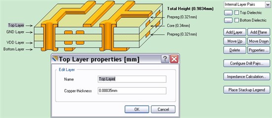

  • I adopted your suggestions to add another connector like P8. I have a saleae logic analyzer.
    Maybe your altium designer version differs from mine. Is the way to keep all files synchronized like this? I used this method.
    I am not familiarize with PCB fabrication process. Do you suggest 'prepreg-core-prepreg' configuration? Please see the screenshot of my Layer Stack Manager.
    I selected the "Internal Layer Pairs" instead of "Layer Pairs".
    In PCB readme file of CC2430DB, it writes:
    4 LAYER PCB 1.112 MM NOMINAL THICKNESS WITH 0.35um Cu PER LAYER
    NOMINAL LAYER THICKNESS (NOT CRITICAL):
                    LAYER 1-2: 0.321 MM DIELECTRIC FR4
                    LAYER  2-3: 0.34 MM DIELECTRIC FR4
                    LAYER 3-4: 0.321 MM DIELECTRIC FR4
                    Dielectric constant for FR4 is 4.5
    Thus, I defined copper thickness 0.00035mm (==0.35um),  made (prepreg=0.321mm, core 0.34mm, prepreg=0.321mm) and force Dielectric constant for FR4 to be 4.5. I am worried if the fabrication vendor can make FR4 with any dielectric constant. Also, I am worried that the copper thickness is too small, almost 1/100 of the default value.
    I read some info about bypass capacitors and now know that they must be close to pins. But you said "There could be a few more bypass caps", do you mean adding a few more to battery and other power lines since bypass capacitors do not hurt anything and could only make things better?
    Thank you.
  • You seem to have mastered Altium.  Here is the glossary from Sunstone.com http://www.sunstone.com/customer-solutions/circuit-board-glossary.aspx  it is short but covers it all in detail with excellence guidance. I suggest you read it.
    I typically use Sunstone and like them but its where I had the first boards made using thier pcb123 v2 software and quick turn service and have not shopped around much so you may find one you like better.  I'm working with someone who uses PCBCART.com, his boards are blue with gold contacts and look great, he says the prices are great. The pcb fab house you choose will have a standard stack up that you will need to use.  Other's on this forum have correctly written you can specify the desired impedance and let the board house dial in the layer 1-2 thickness to nail it perfectly. This is true using a fab's full feature service and I have done this for a few customers but figure $1200-$1400 for a fab run instead of $330 using standard quick turn parameters.
    Bypass Caps:
    Notice the bypass cap placement is near the pin with a ground close to it.  The wire from VCC goes to the cap and then to the pin. With this arrangement the VCC line can be somewhat long. Pictured is a LNA/Power amp, like the RF section of the CC2430 placement is more critical here than on a voltage regulator or accelerometer. Space limitations do not always permit perfect placement. Sometimes VCC is routed directly to the pin with a short wire to the cap. In cases like the VR the cap is there to filter out ripple (<1 MHz) and will work when placed within inches of the device.  At times they are to low pass filter switching transients from logic drivers (<100MHz) and can be placed within ½ inch and near the line. The caps that are providing a RF ground at 2.4GHz and above need to be within 50 to 100 mils and should be wired directly to the pin. VCC should be applied at this low Z point to maximize the suppression of RF radiation. The ground point also must be placed close.  The  5 VDD pins (pins 27-31) are next to the RF pins and directly connected to the VDD_1.8 via with only one bypass cap 265mils away, the ground for the bypass cap is another 240mils away. One can check the box and say there is a bypass but in effect it is not doing much.  The reference design at http://focus.ti.com/general/docs/lit/getliterature.tsp?literatureNumber=swrr012c&fileType=zip has a variation for pins 27-31 in the Layer-1.pdf file that you lift directly.
    Hope this helps.  Once you get the next version set along the .pcbdoc and I'll take a look.

    I know a bit about microstrip, characteristic impedance, etc. You told me layer 2-3 and 3-4 thickness does not matter. It makes sense in my drawing since layer 2 are poured with a large area of GND. However, I checked CC2430DB drawing, beneath balun, layer 2 is not poured with GND, so is layer 3 and until 4 we have a wide area of GND. The substrate height is not just 0.321mm.    Am I just worrying too much?
    Thank you for pointing out my flaws and mistakes. And I also thank you for your advices, encouragements and precious time taken to clear my doubts.
  • Good catch, the performance would have been very bad if you had left this unchanged.  You must maintain the W/H relationship for the RF lines where W is the width of the line and H is the height of the line above the ground plane.  H in this case is .321mm + .340mm+ .321mm or .982mm.    My guess Ti lifted the CC2430EM design off a 2 layer .032” board.  There are 3 pieces of good news.
    1.)     Since the dielectric is now nearly 3 time thicker the design is less sensitive to small variations in thickness
    2.)     The thickness is mostly driven by the core thickness as opposed to the prepreg, prepreg thickness is much more process dependent and variable.
    3.)     You only have to remove the Layer 2 and 3 plane under the RF circuit be ensure that the performance of the reference design is maintained. A 10 minute task
    In the attached jpg you can see the area I would use a polygon cut out to remove the layer 2 material. Layer 3 can be the same while eliminating it totally on the right and left side.  Keep in mind that every where you have a bypass cap between VCC and ground you are tying VCC to ground (for AC) thus improving VCC as a ground plane, this is a good thing.
    I have looked at the CC2430DB design,  Ti went further removing the inter planes under the entire CC2430 section. Once again my guess is they just lifted the two layer CC2430EM design changing only what they had to.  Leaving the layer 2-3 under this part of the circuit does not impact the RF design and provides better bypassing, improved thermal under the SOC, the smaller H in W/H results in lower impedance lines for VCC etc, and better grounding for the SOC. Also you would have to route longer VCC traces while possibly compromising bypass placement if you went back to 2 layers in this entire section.

  • Hi Mr. Stewart,
    I removed polygon pours on the 2 inner layers under the balun.
    On Design Note DN003, at the end of page 3, it says "The impedance of the traces in the balun is affected by the distance between the traces on layer 1 and the ground plane beneath. Both CC2420 and CC2430 EM reference design uses a 1 mm thick two layer board with FR4 substrate." This suggests under the balun, the board thickness must be 1mm in total. I guess the minor difference between 0.982mm (CC2430DB) and 1mm (CC2430EM) does not matter, the same as what you said -- 'less sensitive to thickness'.
    I removed a few vias. Is it because those large vias take too much area and the polygon pours hardly have any presence amid the gaps?

  • Turn off single Layer mode to better see the silk text over pads,  DRC shows 71 silk to silk violations including "CC2430 SOC"  text on solder pad.. See photo.
     Turn on rule checking for silk to silk (set 0), silk to pad (set 6mils), antennas( set 0), solder mask sliver(set 4mils). Set the Solder Mask Expansion rule to 2mils.
    The typically green Solder mask board coating  is great stuff, solder will not stick to it causing the solder to flow where the metal is even when the solder paste looks shorted before reflow. The solder mask in the layout is a window in the mask that prevents  the copper pad from getting cover with solder mask  coating.  Solder Mask Sliver is the thin area of solder mask material between Pads.  You currently have 4mil expansion, with 9mils between CC2430 pads this leave 1 mil slivers. You can see it in the photo. Due to errors in mask alignment etc this will end up with breaks in it permitting solder shorts that can not be cleared. Just change the expansion rules as above and all will be redrawn after you re-pour the polygons.
    For future reference it is better to have a 8 mil expansion with less by rule for specific components that require it.  Key is to have the maximum sliver between parts to minimize solder bridging and 4 mils is the minimum to be effective.  Better to have solder mask covering a bit of copper pad that have shorts under a QFN or BGA. When you create a footprint think about the gap between pads and how much of it will be solder mask expansion and how much will be solder mask silver.
    The text has to be moved from the pads, next drawing the outline of the board with a line on the keep out layer, this is used by the fab house to set up the saw to cut the board from the panel, then you are ready for fab.  It would be good to change the expansion to 2mils for all or better is 2 for the CC2430 and ADXL345 by rules and set All to 8mils. The 1 anttenna DRC error is on the wide VDD line near C104 and can be ignored.  From transmission line theory open circuited stubs behave like shunt caps and are bad on high speed lines. On a DC line it does not matter.
    Next is the fun of creating the Gerber file folder which I find frustating in Altium. Under file you select Fabrication files select Gerber which creates a CAMcastic folder. In this folder you select Gerber again to actually create the Gerbers.  Select 2-3 for xx.xxx data format, make sure you do not include mechanical layers in the output. Last you need to view the Gerbers to make sure you got it right. Download ViewMate from http://www.pentalogix.com/ (it is free) and recomended by various fab shops.
