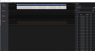

I am attempting to use the UART2 driver but it appears there may be a bug.  I am running at 3M baud, and have sniffed the data on a logic analyzer @ 3M baud, and the data on-the-wire appears correct.
When UART2_read returns, I receive the correct number of bytes received (256), but after 50 so bytes, there is incorrect data.
Is this a known issue with UART2 driver?
Ben
  • every byte received should be 0x31, but after 55 bytes they begin to look corrupted.
    On sdk 5.2

    When using UART2_ReadReturnMode_FULL, I get all the data, but if I use UART2_ReadReturnMode_PARTIAL, I don't get all the data.
    Furthermore, if you look at the scope trace, you can see that the data transmitted from the PC host to the CC1352 device (Rx trace) took longer than the data the CC1352 transmitted back to the PC host (Tx trace). Even though both transmissions use the same baud rate.
    So I guess that your option here would be to either use Partial return mode and handle such cases, or use UART2_readTimeout() with Full return mode, while setting a sensible timeout value. Then you can use the bytesRead parameter to determine the amount of data that you have received.

  • Hi Andres, thanks for looking into this.  You were right, the baud rate change didn't fix it entirely, this issue started rearing its head again soon after I changed to that.
    So my datastream coming in is definitely at 3Mbaud - no gaps.
    So I don't think the partial read mode is to blame.
