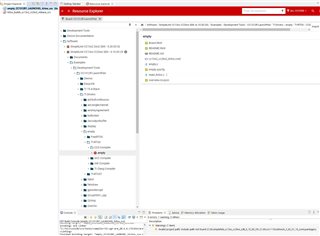

Hi Marie
Thank you for getting back, Yes I can confirm they are installed in the relevant paths please see below, how do I change an existing TI-RTOS6 projects to TI-RTOS7, also I would like to cure the original problem.
Thank you for your help
David
Hi David,
1) You can import the TI-RTOS7 version of the project from the tirtos7 folder, e.g. C:\ti\simplelink_cc13xx_cc26xx_sdk_6_10_00_29\examples\rtos\CC1312R1_LAUNCHXL\drivers\empty\tirtos7 .
I haven't seen your build error before, so I'm tempted to just ask you to start a new CCS workspace and reimport. But a few other things to check:
2) Can you confirm CCS version is 11.2.0?
3) Is XDCtools v.3.62.01.16_core installed if you check CCS Preferences?
4) Is this version selected if you check your project Properties?
Cheers,
Marie H

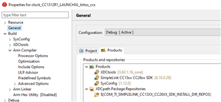

Hi Marie
Thank you for getting back to me.
I have renewed the workspace and the problem still persists.
I am using CCS 11.1.0 can you please tell me where I update this.
below are my equivalent screen shots to yours.
David

Hi David,
You can safely ignore this warning.
If you want to remove it you can go to the Project -> Properties of the tirtos builds project, -> General -> Products -> XDCpath Package Repositories and set this one to your install path.
