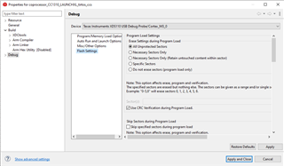

The error I get is:
error #10099-D: program will not fit into available memory, or the section contains a call site that requires a trampoline that can't be generated for this section. run placement with alignment fails for section ".TI.bound:flashBuf0" size 0x2000, overlaps with ".common:structname ", size 0x0002 (page 0)
Please inform me how I can resolve this.
