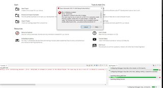

I have just updated my debugger software and now cant get it to work, please see attached error.
David

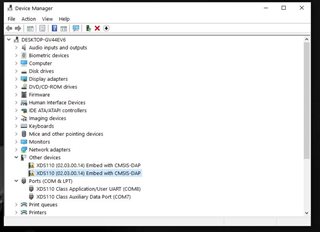

I failed to mention that the problem I have is with the 2 new CC1312R launchpads not the old one's, when I looked at the device drivers I notice there are only 2 entry's in the device table on the old boards (these work) when I try the new boards I get 4 entry's in the device table please see attached, can someone please assist.
David

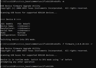

Hi
I have now tried to update the firmware file according to the PDF please see attached
As you can see I can put it into DFU mode but as soon as I add the next line it tells me its not in DFU mode???????????
David
Hi David,
I understand that this is not something you want to experience when receiving a new board. Unfortunately upgrading the firmware on the XDS110 can sometimes fail, as indicated in my previously shared E2E thread.
From your screen shot it definitely looks like the device is in a wrong state (most likely as a result of the failed firmware upgrade) since device name, manufacturer and serial number are unknown.
Can you please try to follow the instructions, for installing the bootloader and upgrading the firmware, in the E2E thread linked to earlier? This is the best advice we have for you.
