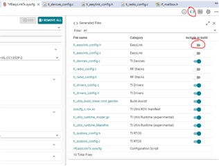

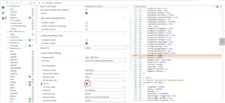

  • Hey Alexander,
    Is it possible for you to share your ti_radio_config.h/.c files as well as the EasyLink config files?
    Arthur
  • Sure, here they are

  • Hi Alex,
    In ti_easylink_config.h, I see that EASYLINK_PARAM_CONFIG is still set to "EasyLink_Phy_2_4_250kbps2gfsk", thoses do not seem to be your newest settings, unless they have the same name.
    Also, could we have the .c files as well?
    Arthur
  • Hi Arthur,
    thank you for your reply. It seems I forgot to change the setting before posting them (since I continue my work on the pre-defined radio setting until we figure out the error).

  • Hi Alexander,
    Indeed, this does not seem to be it..
    FYI, you can disable file generation , once they have been generated using the following menu:
    Simply copy the files you want to keep somewhere else in the project, then untick the files you want to keep the modifications on.
    The RF_MODE definitions you are seeing are actually here for backward compatibility reasons, and thus indeed do not have any impact on the CC1352P
    Arthur
  • Hi Alexander,
    I managed to reproduce the frequency setting issue. Indeed, in your radio_config.c file, the txPower field of your RF_cmdPropRadioDivSetup structure is set to 0xFFFF. Can you try setting it to something like 0x7212?
    It looks like there is a problem with the High PA setting in Sysconfig/Easylink, which could be a bug.
    Arthur
  • Hi Arthur,
    thank you, this was it. The .txPower was 0xFFFF in the RF_cmdPropRadioDivSetup structure, as you said. I've also reproduced how this value was set in the first place and it turns out it is set when I enable High PA in SysConfig, see picture below. And since none of the CC1352P boards do not currently support High PA on proprietary radio, it can be disabled anyway.
    It might be only a problem with my version of SysConfig (1.12.0) and maybe it is fixed with the currently newest version (1.13.0), though.
    Thank you again.
