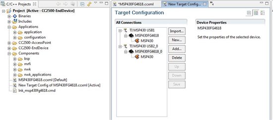

  • Hi again,
    I followed the instructions from the link I gave you before to modify the Target configuration and I have it as the picture show:
    Nevertheless, when I click on debug I get this error:
    Error initializing emulator:
    Only one MSP430 device can be accessed at a time per each CCS process. Please start another instance of CCS for accessing the second FET, or reconfigure your Target Configuration file.
    How do I start another instance of CCS? Is it just another Project in the same workspace? How can I debug the AP and ED projects then?
    Efrain
  • Here is the image, I am sorry I didn't add it properly before.
    Efrain

  • I believe that link leads to the same post I was talking about in a previous comment. But I figured out how to debug the AP and the ED.
    Since English is not my first language I didn't understand what a "CCS instance" was, so I created a similar project on the same workspace and tried to do what was showed on the link we posted before. After going over that and looking for other posts I realized that for the case of the MSP430 you can't have more than one processor on the same target configuration. That is discussed on this post:
    http://e2e.ti.com/support/development_tools/code_composer_studio/f/81/p/104982/370249.aspx#370249
    Then since I had to terminate the debug session if I tried to debug other project within the same workspace I tried launching another CCS (I realized that this happens to be another CCS instance) in other workspace. Nevertheless it wasn't detecting the other FET. Then what I did is to modify the Target Configuration on one of the two instances such that one used TI MSP430 USB2 as a connection while the other kept using the default TI MSP430 USB1 connection. Of course I added the MSP430FG4618 as the device for the modified Target Configuration. Now I am modifying the code and debugging the projects.
    So in summary, to debug two projects with CCS you need to launch two CCS instances with a different work space on each, and modify the Target Configuration such that the connection is not done by the same device.
