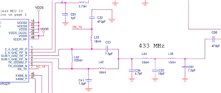

HI Zack,
if customer want to make a 433/470~510MHz band on 5x5 package of CC1311. do you have recommendation how customer can start the design?
for 7X7mm, I recommended them refer to CC1310‘'s reference.
BR. Albin
Hi Albin,
CC1311R3 7x7 mm package:
For the CC1311R3 7x7 mm package we would not recommend the CC1310 design for 433 MHz.
Instead, the customer can use the LP-CC1312R7 (SWRC371): https://www.ti.com/lit/zip/swrc371 as a starting point, then use the 433 MHz BOM from the LP-CC1352P7-4 (SWRC373): https://www.ti.com/lit/zip/swrc373
As there will be no switch for the R3 devices, the customer can use the RF path up to C36 in the schematic below (plus the antenna section in the full design):
I will need to double-check the 5x5 mm recommendation and reply tomorrow.
CC1311R3 5x5 mm package:
We also recommend basing the 5x5 mm design on the LP-CC1352P7-4 433 MHz BOM (but with the 5x5 mm footprint).
I've also sent you a friend request. We can provide additional help with optimisation later on (if needed), depending on order volume, so you can contact me if so.
