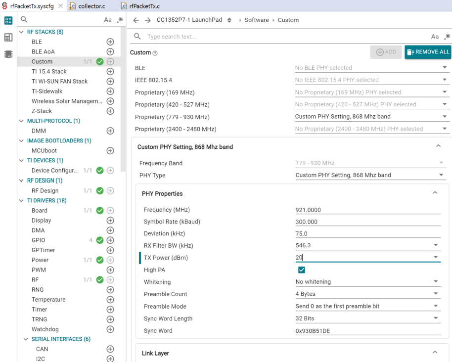

I am trying to use +20 dBm Tx output power, however I am seeing some discrepancy on the output if I set the "High PA "to true on sysconfig. For my test I am using a custom PHY setting at sub-GHz. For any setting of power I use upto 12.5 dBm seem to be working fine. For the verification, I am using Siglent SSA3032X spectrum analyzer connected directly to the SMA connecter on the launchpad.
Let go through the setup and test process,
Test 1
1) An demo application configured with custom PHY setting as on the following screenshot.
2) There a continuous transmission while observing the value on the spectrum analyzer. The output power is around +10.2 dBm wihtout the consideration for connector and cable losses. So, it looks to be alright on this configuration.
3) When opening the sysconfig on the text editor (this is important on subsequent tests), we see the following. (Emphasis on the Tx power)
Test 2
1) Custom PHY setting for the second test. Here, the "High PA" is turned on and the power is set to +20dBm.
2) So, we expect the output power to be +20dBm, right? Wrong. On spectrum analyzer we see the output power around -22 dBm. Which is even worse than without turning on the PA.
3) Interestingly, when opening up the sysconfig in the text editor. We see this. Regardless of what I choose on the output power it is always set to a value from old configuration. But, the "High PA" is set up to True.
One additional test, if I use WiSun instead turning on the High PA automatically sets the output power to 0 dBm. With this however, we do observe the +20 dBm output power.

    It looks very strange and I would first like to check that the radio configuration is correct.
    When you make changes in SysConfig the ti_radio_config.c and ti_radio_config.h are generated accordingly.
    These files show how the radio is configured and can be found in "Generated Source -> SysConfig".
    1. Could you please share them with me for both configuration so that I can check the setup?
    2. Could you also tell me what is the final configuration that you would like to achieve so that I can check what the correct settings are?

    Here is the code of generated source file for first configuration Custom RF @ 921 MHz without High PA on and output power set at +12.5dBm.

    Here is the code to the generated source while in Custom RF @ 921 MHz with High PA on and output power set at +20dBm.
     *  ======== ti_radio_config.h ========
     *  Configured RadioConfig module definitions
     *  DO NOT EDIT - This file is generated for the CC1352P7RGZ
     *  by the SysConfig tool.
     *  Radio Config module version : 1.18.0
     *  SmartRF Studio data version : 2.31.0
    #ifndef _TI_RADIO_CONFIG_H_
    #define _TI_RADIO_CONFIG_H_
    #include <ti/devices/DeviceFamily.h>
    #include DeviceFamily_constructPath(driverlib/rf_mailbox.h)
    #include DeviceFamily_constructPath(driverlib/rf_common_cmd.h)
    #include DeviceFamily_constructPath(driverlib/rf_prop_cmd.h)
    #include <ti/drivers/rf/RF.h>
    /* SmartRF Studio version that the RF data is fetched from */
    #define SMARTRF_STUDIO_VERSION "2.31.0"
    //   RF Frontend configuration
    // RF design based on: LP_CC1352P7-1
    #define LP_CC1352P7_1
    // High-Power Amplifier supported
    #define SUPPORT_HIGH_PA
    // RF frontend configuration
    #define FRONTEND_SUB1G_DIFF_RF
    #define FRONTEND_SUB1G_EXT_BIAS
    #define FRONTEND_24G_DIFF_RF
    #define FRONTEND_24G_EXT_BIAS
    // Supported frequency bands
    #define SUPPORT_FREQBAND_868
    #define SUPPORT_FREQBAND_2400
    // TX power table size definitions
    #define TXPOWERTABLE_868_PA13_SIZE 20 // 868 MHz, 13 dBm
    #define TXPOWERTABLE_868_PA20_SIZE 8 // 868 MHz, 20 dBm
    #define TXPOWERTABLE_2400_PA5_SIZE 16 // 2400 MHz, 5 dBm
    // TX power tables
    extern RF_TxPowerTable_Entry txPowerTable_868_pa13[]; // 868 MHz, 13 dBm
    extern RF_TxPowerTable_Entry txPowerTable_868_pa20[]; // 868 MHz, 20 dBm
    extern RF_TxPowerTable_Entry txPowerTable_2400_pa5[]; // 2400 MHz, 5 dBm
    //  RF Setting:   Custom (50 kbps, 25 kHz Deviation, 2-GFSK, 100 kHz RX Bandwidth)
    //  PHY:          custom868
    //  Setting file: setting_tc706_custom.json
    // PA table usage
    #define TX_POWER_TABLE_SIZE TXPOWERTABLE_868_PA20_SIZE
    #define txPowerTable txPowerTable_868_pa20

    // TX Power (dBm): 20

    uint32_t pOverridesTx20[] =
        // override_tx20_placeholder.json
        // TX HighPA power override
        TX20_POWER_OVERRIDE(0x001B8ED2),

    2) I am trying to achieve +20 dBm output power with sub-GHz with custom proprietary radio settings. So this is the configuration I was,
    Thank you.
  • Hi Saugat,
    I apologize for the delay.
    I verified the radio settings of our project by importing rfPacketTx_LP_CC1352P7_1_tirtos7_ticlang from the SDK.
    I changed the custom PHY to 20 dBm on 921 MHz as below:
    When testing the board in the lab I see +20 dBm on the spectrum analyzer.
    Could you please follow these steps and tell me if you can replicate it?
    Kind regards,
    Theo
