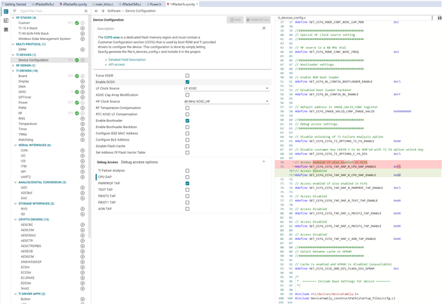

When outsourcing to a programming house, how can we enable the 'lock debug interface'?
Hi Kimi
Please see the 11.1 Customer Configuration (CCFG) section in the TRM.
The ccfg can be configured using sysConfig:
BR
Siri
Hi Siri,
Thank you. It works
Glad to hear you were able to get it to work.
