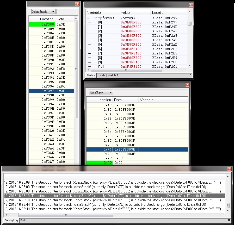

CC1110 IDATA Stack Overflow After 3-4 hours Of Run Time
The following function is called to do 527 ADC conversions.  After each conversion, an interrupt occurs during which the ADC result goes through a bit resolution function and then is stored into an array called tempSamp defined as a float type.  The array was defined and initialized to zero in xdata memory prior to starting main().
  for (bufferNum = 1; bufferNum < 528; bufferNum++)
  { cycle = 0;
    ADCCON1 |= ADCCON1_ST | BIT1 | BIT0;  //Execute ADC conversion
     while( cycle == 0 );  }
The program runs between 3-4 hours without any problems but then an idata stack overflow occurs and the program stops.  If I run the device like I want out of debug mode, it also stops after 3-4 hours probably because of the idata overflow issue (although I don’t know for sure because of not being in debug mode).   I have read in a different forum that it is not a good idea to define a large array in a function.  From debug mode, I know for certain that the stack clears after the ADC function for a couple of hours.
I don’t externally reset the device without restarting the debug session, the power supply remains sufficient, I don’t enter any PM modes, and haven’t experienced known problems with the debug signals.
Any thoughts about why the stack would clear 3-4 hours and then stop clearing when the code is just going through a big loop?
Is watchdog reset mode my best bet or is there a way I can make sure the idata stack is cleared after the ADC function?
IDATA Stack size setting: 0x80
XDATA Stack size setting: 0x1FF
-JD

  • Hello JDBC,
    I am not sure of this, but I would recommend you to try to run the code with integers instead of floats to try to verify of this is causing the problem or not. The 8051 processor do not have floating point instructions so all operations must be emulated which might give rise to a "bloated" use of the system resources.
    Try to use scaled integers instead of floats. You can use "scaled" long integers ( 4 bytes ) and use integer operations on that. For example if you had the value 2.5 you can just multiply it with 10 and get 25 for use with arithmetic's and then reformat it later if you are to display it on a LCD.
    As you stated, it is a good idea to not define large arrays inside functions. If you do not have deterministic knowledge on when and how often the function is called the application might suddenly expand and fill up the allocated available stack resources in RAM and you might end up with a overflow (usually in XDATA for this specific case).
    BR. Eirik
  • Thank you Eirik.  I came to that same conclusion a few days ago too and have been meaning to update the forum.  The issue had to do with storing the ADC result as a float and entering multiple functions within functions with a large array.  Since I combined the functions into one and made the ADC result an uint16, I haven't had any more issues.  I also think it had to do with going through the ADC loop too quickly and needing to allow enough time between conversions.  Hopefully this will help others with similar issues in the future.
    Thanks again for the expertise!
    JDBC
  • Glad to hear it. Good luck on wards.
    BR. Eirik
