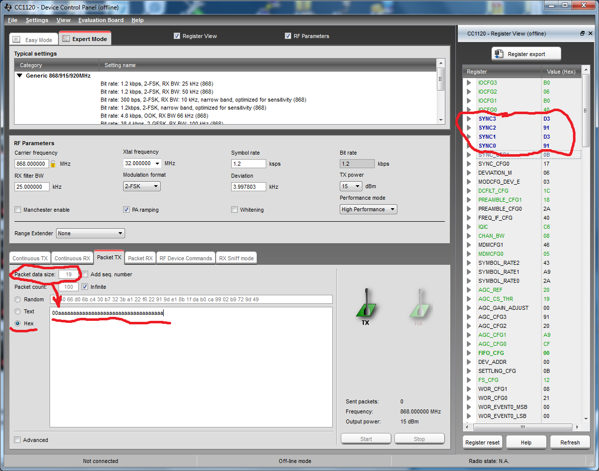

    to use SmartRF Studio as transmitter for TrxEB with PER TEST menu option:
    TrxEB: use EXPERT MODE -> LINK BYPASS MODE -> MASTER
    SmartRF Studio settings like on attached screenshot:
    (SYNC D391D391, Packet length = 19)
    It works for me with CC1200.

  • Dear Oleg Pushkarev ,
    I did as you advised. I am happy I have about -9dBm receive power :) :) :) :) thank you.
    p.s. How did you find about the packet size ; 19 ? TrXEB PER test does not receive for any other packet size. Its the same case for the sync word? Are both the packet size and sync word hard coded in the TRxEB?
  • Hi, I found out it by receiving TrxEB PER TEST packets by SmartRFStudio (revers engineering :). It's very convinient to use autonomously working TrxEB with RSSI graph for evaluation custom RF boards. So I wish TI provide clear instruction how to do it without digging into PER TEST code. By the way TI did this useful instruction www.ti.com/.../swra468.pdf .
    BR
  • With packet size 19 and SYNC 3,2,1,0 registers D3 91 D3 91 respectively I am able to receive packets sent from PER test using the PC. Thanks
