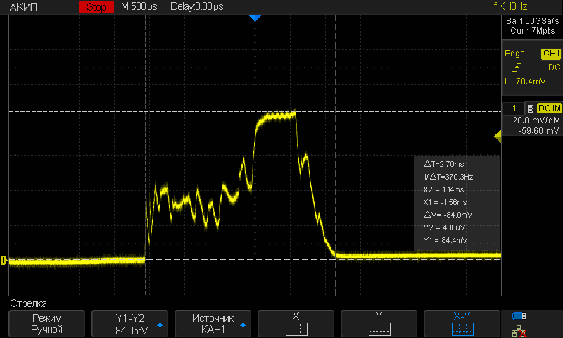

    I could measure current consumption for active RX phase, but I wonder how big is current consumption between RX ON states and average volume for rfWakeOnRadioRx sample application?
    I can not use my DMM because of small time between RX activity (just 500 ms).
    Here is CC1310 rfWakeOnRadioRx consumption measured on 10 Ohm resistor in power line (XDS100V3 disconnected)

  • Hi, Siri,
    Am I understand right - average current for this sample application is 52.472 uA and I should use this figure to calculate battery life time? Of course we need to add real RX activity - data receiving and faulse activity due to interference.
    What is measurement settings for above screenshot (measurement device type and method)?

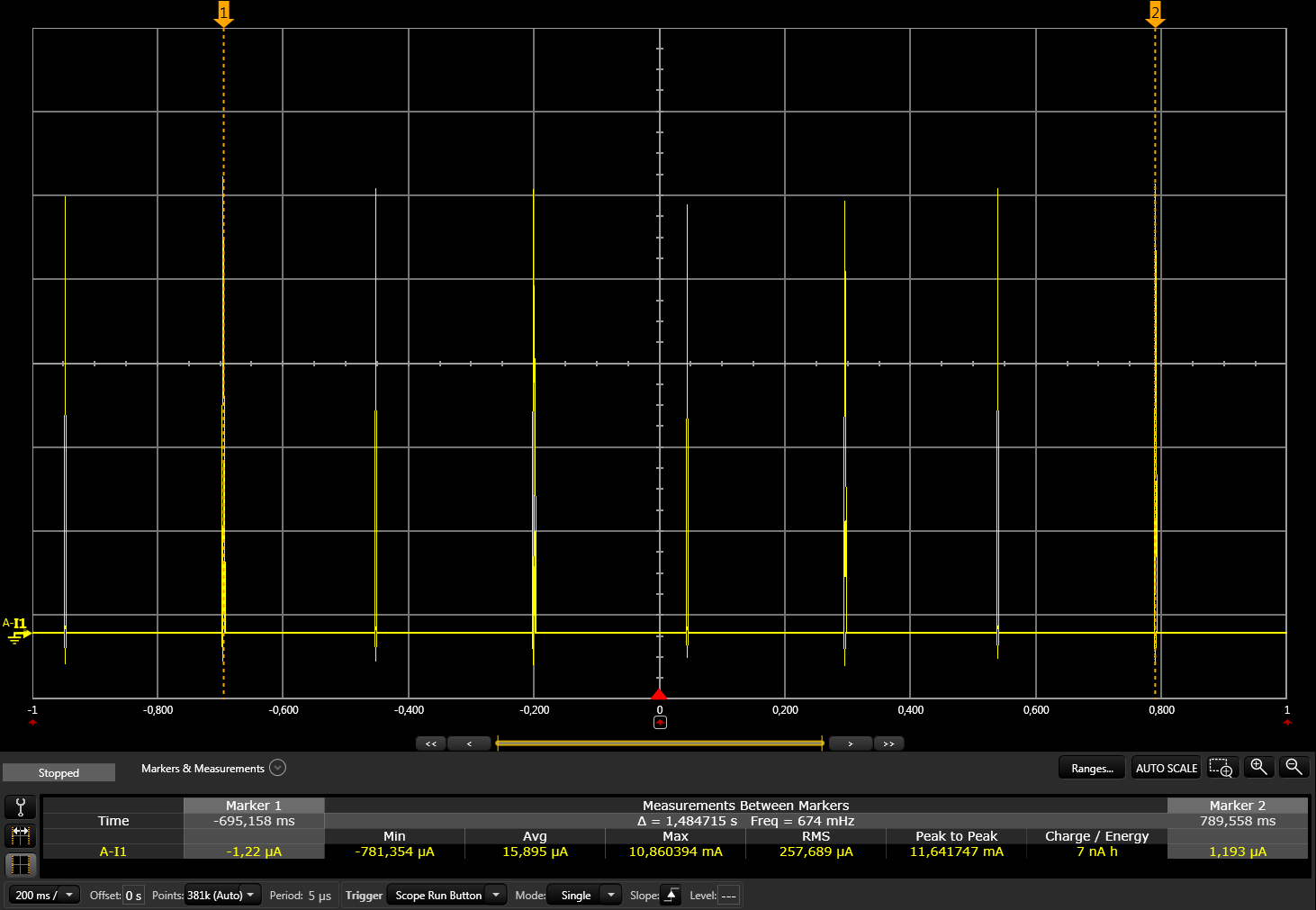

  • Thanks for the test Siri, much appreciated.
    The average is done over 1 sniff command and 2 stand-by phases, wouldn't it be better to do it with Marker 2 at around -0.43ms.
    The results do seem very positive though.

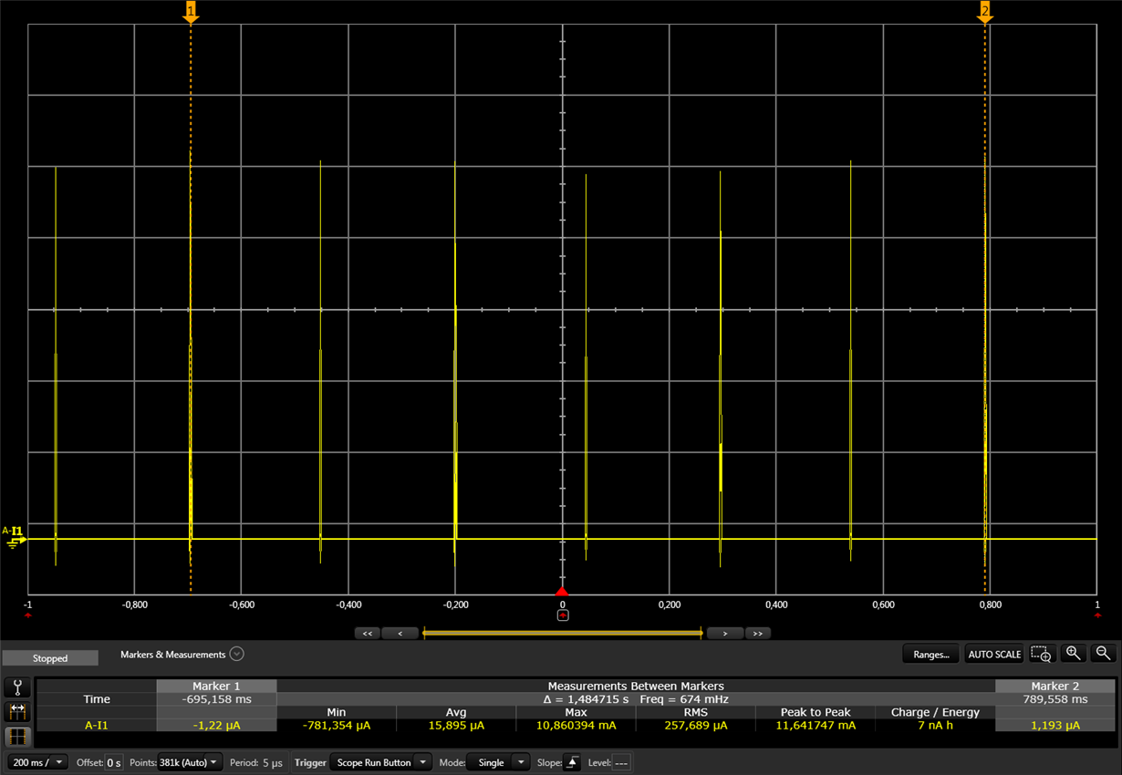

  • Hi Oleg
    The plot was meant to show the average current consumption when the chip is in standby. This average current consumption is 542 nA in my case.
    In the test I did, the radio enters RX every 500 ms (it is in RX just before cursor 1 and just after cursor 2). The peak in the middle of the plot is the recharge current in standby (please see http://www.ti.com/lit/swra486) for more details.
    BR
    Siri
  • Hi Scot
    The average current consumption (when taking RX into account) was in this case below 16 uA.

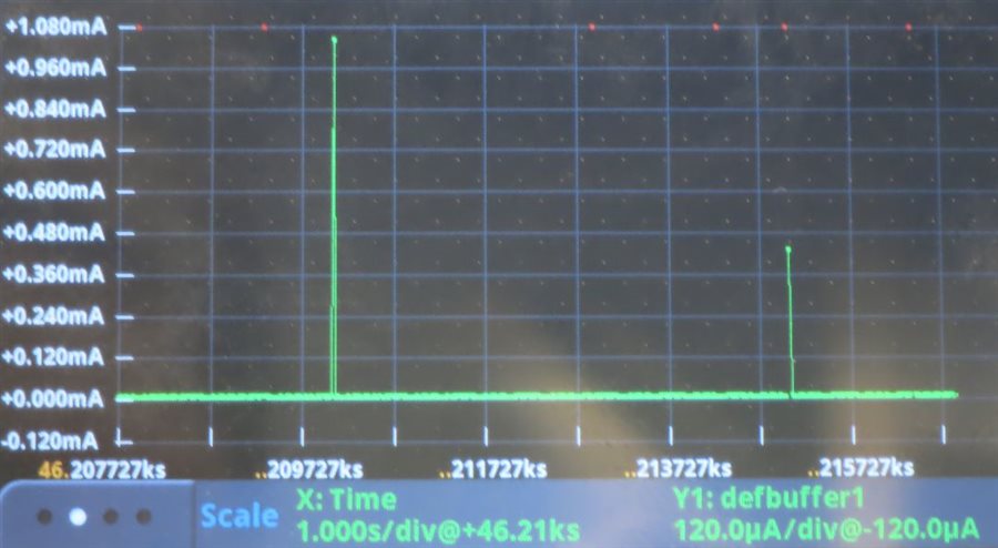

  • I am testing on the Launchpad for CC1310, and between RX I am getting 7.75uA (on a 3.3V supply) and during RX current goes up to 8.135mA. With a WOR interval of 1s instead of 500ms, the average current consumption is 618uA. The two modifications I made to the rfWakeOnRadioRx example project were to reduce the WOR rate, and to modify smartrf_settings.c to operate at 915MHz. The XDS and LED headers have been all removed, and dropping the CPU frequency to 6MHz from 48MHz doesn't change the supply noticeably, are there any sources that could account for this extra current? (I'm assuming the antenna mismatch from moving to 915MHz would change the RX current requirements slightly, but I'm also seeing more than 10x current in standby).
  • SpartanEngineer:
    - Normally you will not save any current by reducing the CPU clock. You will reduce power for one time unit but you will use longer time to do a task.
    - The numbers you report sounds a bit strange. How long are you staying in Rx when your average is 618 uA? Could you post a plot that shows the power profile over a couple of wake ups?
  • I've bumped the CPU clock back up to 48MHz since it doesn't seem to affect average power much.
    The last time I measured with a meter, the RX lasted only one sample (less than ~68ms). Out of 200k samples collected, 15k were at the higher current, the rest were lower than 10uA. Attached is a plot of my latest testing, where I reduced symbol rate to 2.4kBaud, and deviation to 1kHz which seemed to help peak power - the frequency of high current events has also been reduced since I'm now doing a WOR wakeup every 5 seconds, but the time it spends high is the same.
  • Could you also zoom into one of the peaks? Do you have a differential probe and measure the voltage over a series resistor or how do you measure this?
    Is the current consumption when you actually receive a packet or is it when it goes up in Rx, check if it's a preamble on the air and goes to sleep again?
  • I've attached a slightly zoomed graph, the peak only shows up as one sample so I'm also including a table that shows one of the peak values. To measure the current, I disconnect all jumpers on the Launchpad, then connect the GND jumper and the USB cable. I am using a Keithley DMM7510 to then make a current measurement by connecting the hi-probe to the 3.3V on the XDS side and the lo-probe to the 3.3V on the CC1310 side. In this case the current consumption is without receiving a packet, only the periodic wake up; however, the peak current doesn't change even if I am transmitting packets.

  • I changed ccfg.c to make SET_CCFG_MODE_CONF_DCDC_RECHARGE 0x01, then turned on local optimizations with -mf 2 in the project properties. The reported average current is now 20uA, probably slightly higher than default (<16uA) because of antenna mismatch at 915MHz, but much better than my initial results.
