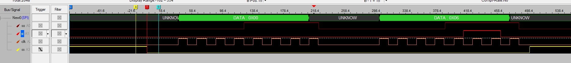

  • Screens from the debug (in the run time the values are like described previously - wrong):
    Write to IOCFG2 value = 0x06:
    Read of IOCFG2 seems to be OK:
    Read form RCCTRL1 (it differs from the value from data sheet):
  • Your SPI looks OK when it comes to phase and polarity. I did a test where I read the RCCTRL1 register just after a reset and I read the correct value. The plot is shown below.
    Since you are seeing different results when running from the debugger compared to free-running, I would suggest that you use a scope instead of a logic analyzer to verify that all your SPI timing is within spec.
    Also note that some registers has R0 bit fields, so if you try to write these fields to 1 you still reads back 0.
    BR
    Siri
