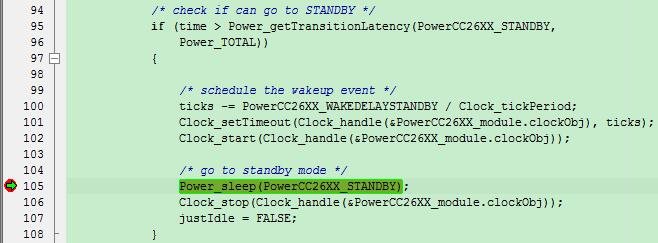

  • hi  richard
    1.  Because I set constraints in "main" before "bios_start", so I need to  release constraints before CC1310 enters standby mode.
    2.  When I  measure curernt, I disattach The debugger and remove all jumpers in P408,and the current is 200uA in low power mode, 3mA when wakeup.
    3.  In debug mode,I followed into PowerCC26XX_standbyPolicy function, it truely enters standby,as below:
    4. My test code didn't intial any peripheral, so I think setDependency()/releseDependenc() is not needed. But , for example,if I need uart,  when uart_open, Dependency  is automatically set. So ,in your opinion, do I need to add extra setDependency before uart_open?
     Now I really have no idea about how to enter or exit standby,  what else do you suggest?
