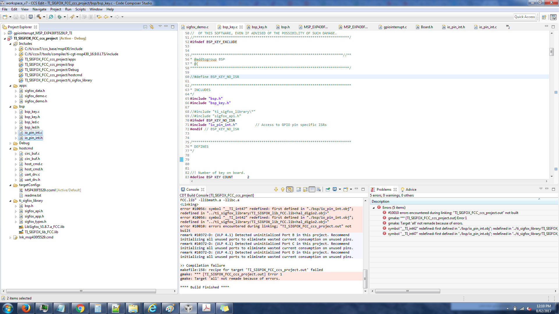

Here is a summary of the problem:
1) To use interrupts in SIGFOX_DEMO_button_press, "#define BSP_KEY_NO_ISR" statement in bsp_key.c needs to be commented out and bspKeyInit function in sigfox_demo.c/SIGFOX_DEMO_init_mcufunction needs to be called with 'BSP_KEY_MODE_ISR' argument (this is described in code brief). I did these changes, but the project did not compile since "io_pin_int.h" header file included in bsp_key.c  is missing from the project (this is the original project sent by Sigfox after providing them the device id).
2) Then I found the CC1120 Easylink source code from the TI website which includes all bsp and io_pin_int files. I have added io_pin_int.h and io_pin_int.c files to the project. (please see screenshot below for the directory structure of the project).This time project went pass the compile phase but failed in linking saying PORT1_VECTOR  and PORT2_VECTOR interrupt vectors are already defined in TI_SIGFOX_Lib_FCC.lib and redefined in io_pin_int.c:
<Linking>
error #10056: symbol "__TI_int47" redefined: first defined in "./bsp/io_pin_int.obj"; redefined in "../ti_sigfox_library/TI_SIGFOX_lib_FCC.lib<hal_digio2.obj>"
error #10056: symbol "__TI_int42" redefined: first defined in "./bsp/io_pin_int.obj"; redefined in "../ti_sigfox_library/TI_SIGFOX_lib_FCC.lib<hal_digio2.obj>"
error #10010: errors encountered during linking; "TI_SIGFOX_FCC_ccs_project.out" not built
Apparently PORT1 and PORT2 vectors are defined somewhere in the TI Sigfox library. Since it is pre compiled I can't check or modify Sigfox library file. If I comment out PORT1 and PORT2 interrupt vectors from io_pin_int.c the project builds but custom interrupts registered don't work because there is no connection between the port interrupts vectors in library and my custom interrupt functions registered in bsp_key.c.
I tried with both TI 4.4.8 and 16.9.0 LTS compilers but didn't make any difference.
I am wondering whether or not there is a way to register custom interrupt functions to the ISR defined in Sigfox library or any other solution.Is it possible to get some help and guidance in this problem?
