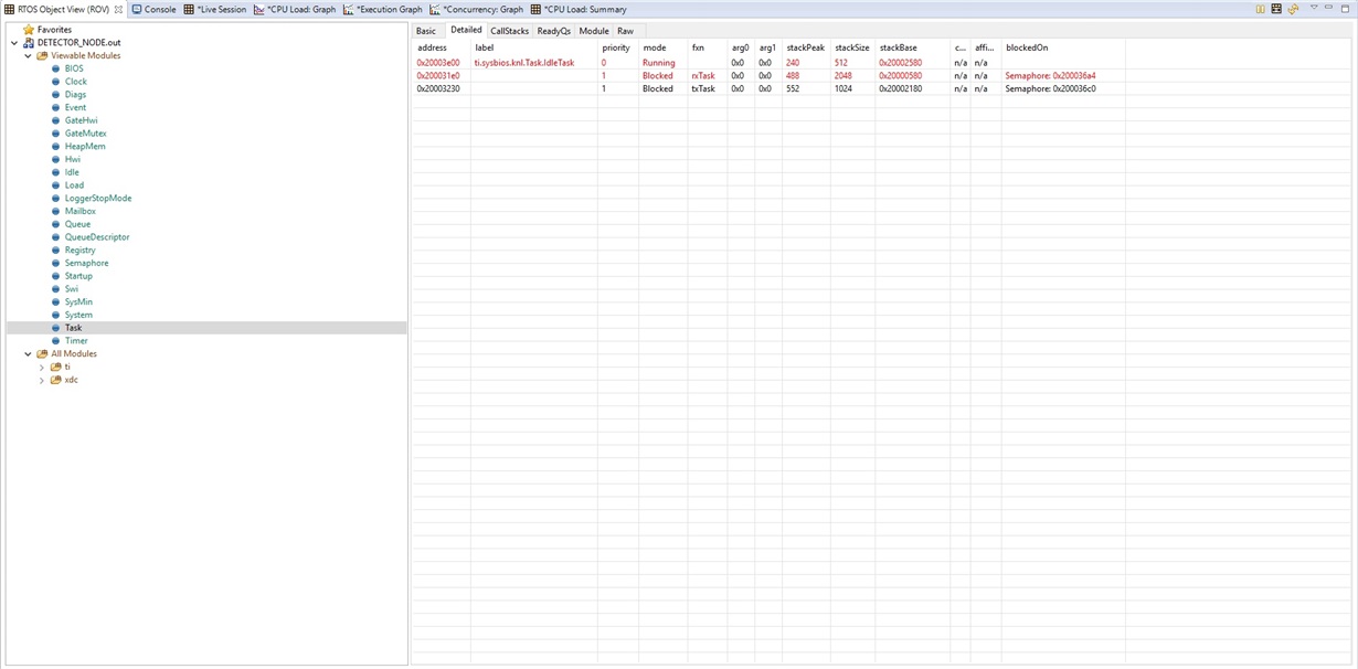

  • Another update:
    I could see in ROV that the Idle task is running:
    So I'd like to know if you have any suggestions to what may be causing this high consumption.

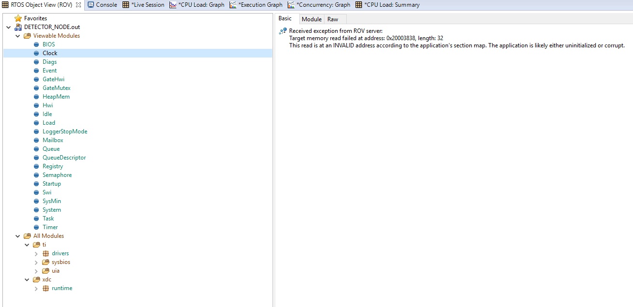

    I am using the EasyLink API in the radio, maybe that's the problem (since I don't see the radio getting shutdown after EasyLink_transmit() or EasyLink_receive())??
    Also in ROV it says my clock instance (which I created dinamically) is uninitialized or corrupted, even though it works fine during execution:
    Any help will be appreciated.
