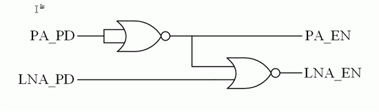

  • Jim, I am trying to solve the same thing. Looking at your solution, some things are not clear to me
    1. You wrote: The best suggestion I can give you right now is to use the IOCFG1/PA_PD
    While the default configuration is IOCFG0/PA_PD, is it a typo?
    2. Citation: This has the additional benefit that it eliminates the possible invalid state where both the PA_EN and LNA_EN signals are high at the same time
    but the logic on attached picture is not preventing this, as when PA_PD=low, then PA_EN=high, now toggling LNA_PD will give LNA_EN either high or low depending on LNA_PD. Am I missing something?
    3. The LNA_PD signal is not the LNA_PD signal that one can put onto GDO pins, but a signal that I'll create in my code, thus setting it "manually", right?
  • Adam,
    With regard to...
     1) Yes it is a typo and it should have been IOCFG0/PA_PD.
    2) The logic diagram is incorrect.  I failed to swap the logic operator when I applied Demorgans theorem.  The intended logic was to prioritize on the PA_EN state so CCA would work.  Here is the correct truth table, Karnaugh maps, and Boolean algebra
    and here is the corrected logic diagram
    The correct part would be SN74AUP2G02 located here http://focus.ti.com/docs/prod/folders/print/sn74aup2g02.html
    3) Correct.  The "manually" statement intends for you to manage this signal within software via your own code.  The simplest and most portable mechanism (with respect to updating the SimpliciTI code) would be to create small, possibly inline, wrapper functions which apply the change of state for the LNA_PD signal, call the intended function, and restore the state of the LNA_PD signal.
    Thanks for keeping me honest!
    Jim
