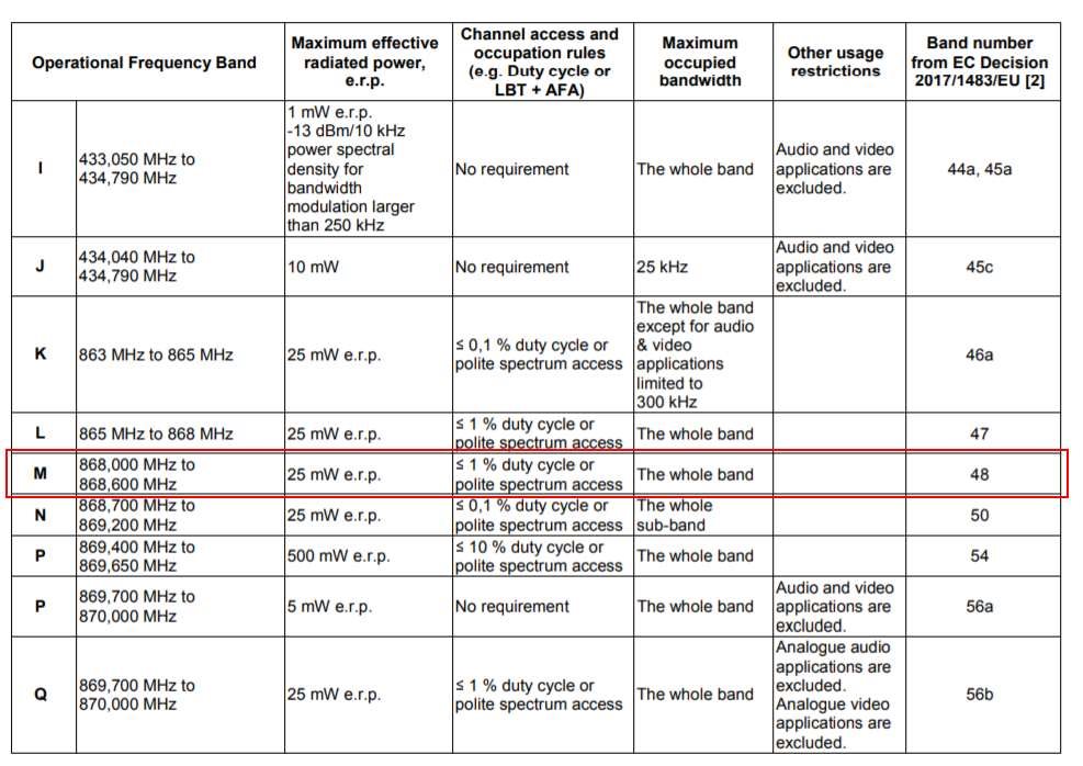

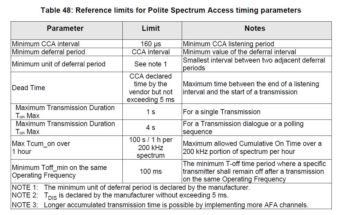

I need some suggestions about ETSI EN 300 220-1 duty cycle and polite spectrum access,
My device uses 868.1MHz, 50kbps, 2-GFSK, 25kHz deviation and implements WoR(0.5s preamble) and LBT on my CC1312R code.
Do I need to add any limit for RF transmit? like after sent a WoR packet, delay next WoR packet 50 seconds for meet the duty cycle?
or just select polite spectrum access is sufficient?
