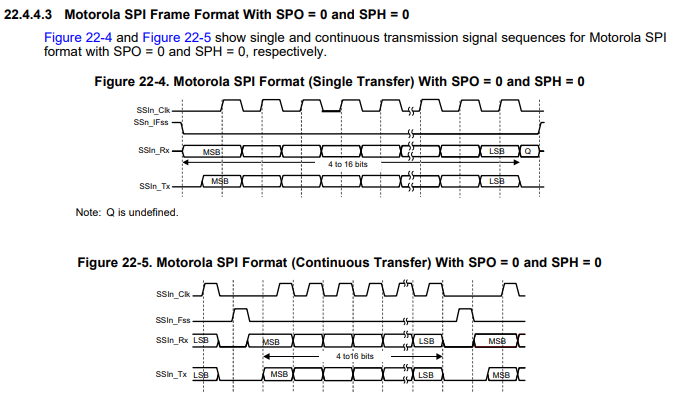

  • Andrew,
    Yes, the SSIn_FSS pin is active low and is pulled down during the entire transmission of the frame.
    A uint16_t scratch buffer is used to allow SPI_transfers where txBuf or rxBuf are NULL. Rather than requiring txBuf or rxBuf to have a dummy buffer of size of the transfer count, a single-word UDMA accessible uint16_t scratch buffer is used. When rxBuf is NULL, the UDMA will transfer all the received SPI data into the scratch buffer as a "bit-bucket". When txBuf is NULL, the scratch buffer is initialized to defaultTxBufValue so the uDMA will send some known value.
    Below is the timing diagram of the Motorola SPI Frame Format w Mode 0. Note the difference of how this works between Single Transfer and Continuous Mode.
    Below is the timing diagram of the Motorola SPI Frame Format w Mode 3, which covers both single and continuous transfers.
    Is the TX FIFO empty when the master initiates transaction? If so, the slave will transmit zeros.
