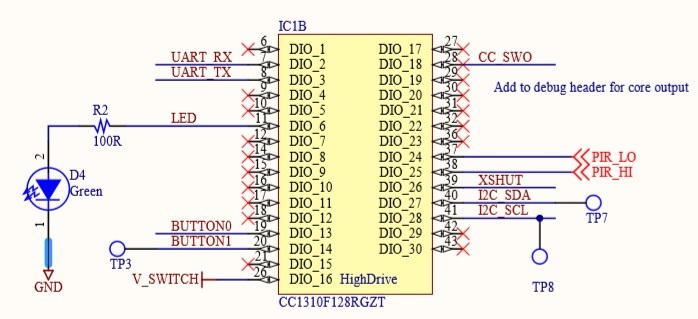

I hava a custom board as follow:
I have 2 i2c devices on this board (not sure if this causes the problem), a vl53l0x TOF sensor and a SHT21 temperature and humidity sensor, both with the same sda and scl, hooked up on dio27 and dio28 respectively.
I could make the SHT21 work, i could get the temperature, humidity readings fine, no problem.
However, i couldnt get the vl53l0x TOF sensor to work, I2C_transfer() would return false.
The following is my code snippet:

  • I would suggest you to use protocol analyzer or scope to check if there is correct signal on SCL/SDA pins when your application calls I2C_transfer.
  • - Since you are able to get the I2C interface working towards a different sensor this is not a issue related to our chip or driver.
    - Check that you use he recommended pull-ups on the lines
    - As YiKai suggested, you have to monitor the lines connected to the sensor and compare them with the sensor datasheet.

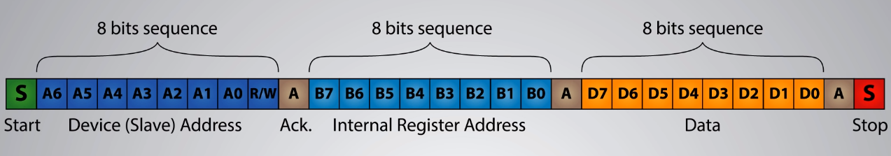

  • I think I have to write data into specific register/ index for the TOF sensor to work, however I couldnt find any relevant function in the library that could do just that.
  • Hey there, sorry please bear with me, I am new to this I2C thing.
    So, my question would be, how do I put the value of the "Internal Register Address" (shown in image below) into a "I2C_transfer"?
    As far as I know there are only writeBuf, writeCount, readBuf, readCount, slaveAddress, arg, nextPtr in the "I2C_Transaction_" struct.
    typedef struct I2C_Transaction_ {
        void         *writeBuf;    /*!< Pointer to a buffer containing data to be
                                        written. */
        size_t        writeCount;  /*!< Number of bytes to write from the
                                        \p writeBuf. */
        void         *readBuf;     /*!< Pointer to a buffer to store data read. */
        size_t        readCount;   /*!< Number of bytes to be read from the slave */
        uint_least8_t slaveAddress; /*!< Address of the I2C slave peripheral. */
        void         *arg;         /*!< Optional application argument. This argument
                                        will be passed to the callback function
                                        specified by #I2C_Params.transferCallbackFxn
                                        when using #I2C_MODE_CALLBACK. */
        void         *nextPtr;     /*!< This value is used internally by the driver
                                        and must never be modified by the
                                        application. */
    } I2C_Transaction;
  • If you look at the example here: http://dev.ti.com/tirex/explore/node?node=AJWPglhefns2RXGXTeD9QQ__eCfARaV__LATEST this is the first byte in the txbuffer.
  • Meaning that if I were to send 0x01 to 0x80 register I could do it like this:
        txBuffer[0] = 0x80;
        txBuffer[1] = 0x01;
        i2cTransaction.writeBuf = txBuffer;
        i2cTransaction.writeCount = 2;          //number of bytes to send
        i2cTransaction.readBuf = rxBuffer;      //memory location to save read data
        i2cTransaction.readCount = 0;           //num of bytes to save
        I2C_transfer(i2c, &i2cTransaction);
    Am I getting this right?
