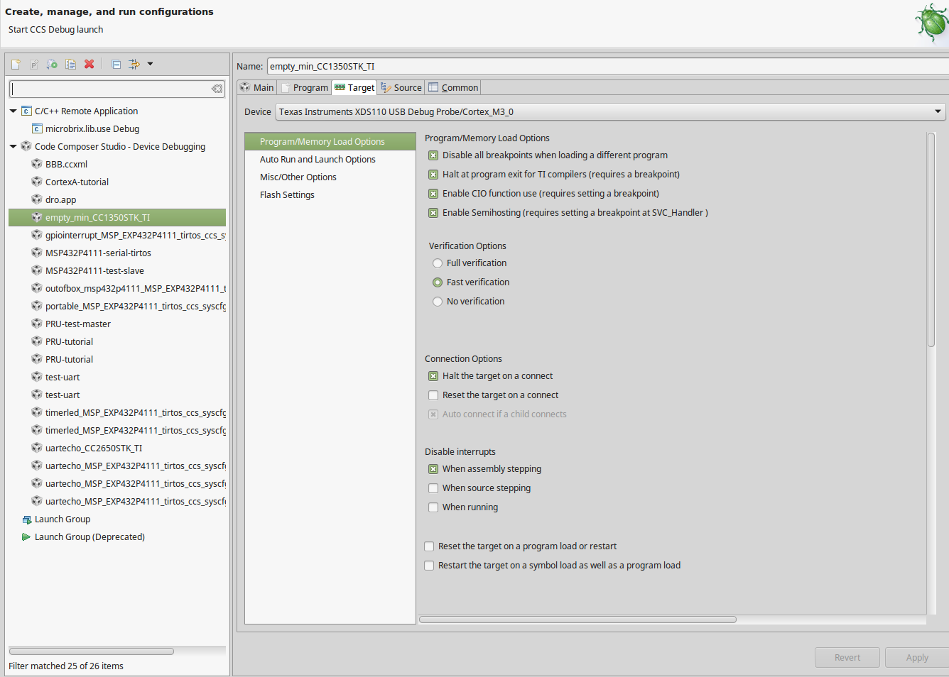

Hi
CCS 9.1 Linux MInt 18
CC1350STK and empty_min_CC1350STK_TI
The project is supposed to blink a LED, but nothing happens. Also right after launching a debug session, the target is running and doesn't stop at main (although this is checked in debug settings that I haven't modified ).
Here is the screen shot after having clickec on the Bug icon of said project that I haven't modified (including the target configuration):
thanks
Peter

  • Hi R.M.
    First, to answer your question, here is a screen shot:
    2) I noticed that I started the wrong project when I opened the ticket.
    What seems to happen in CCS is this:
    - I have an active project A (name in bold in the project explorer)
    - I select another project B (name becomes bold) and I start a debug session
    - the debug session fails and I am returned to the Edit Perspective
    - interestingly the previous project A is again the active one.
    Can you verify this behavior on CCS  Version: 9.1.0.00010 ?
    3) I now have a working debug session and the LED blinks, but only after I modified the target conf file and the debug configuration (Target tab):
    Here are the original settings that came with the empty project:
    The target configuration:
    And the debug configuration:
    These didn't work for me.
    Here is what seems to work:
    Target conf:
    Debug conf:
    Could you share the recommend settings / your settings with me ?
    Kind regards
    Peter

  • Hi RM
    My debugger is here.
    Could you please send me shot of the products you have installed .
    I have now this:
    But this gives me an error:

  • Hi Peter,
    Here's the settings for the tirtos_builds_CC1350STK_release_ccs (empty_CC1350STK_tirtos_ccs inherited this):
    Here's the setting for the empty_CC1350STK_tirtos_ccs:
    Looks like you are using a old XDCtools version?

  • Hi R.M.
    I can confirm that the empty project and other sample projects for the CC1350STK (and the CC2650STK) now work fine.
    I am using the Sensor Tag DevPack rather than the XDS110 standalone debug probe and I can use the target configuration in the samples without further
    modifications. I removed the battery during debugging. I don't quite understand why the connection problems mentioned in this post disappeard after switching to the the DevPack debug probe, though.
    Anyway, many thanks !
