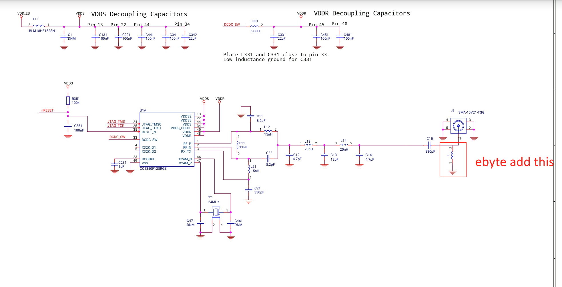

Our sensor (base on CC1310 module E70-433T14S from ebyte) to testing to get certificate.
But our sensor fail at 2 test:
- Test EMC / EMI ==> cause wave interference at 530Mhz frequency.
- RF Harmonic ==> causes strong harmonics at 868Mhz and 1301 Mhz
Any sugget what cause the problem.
